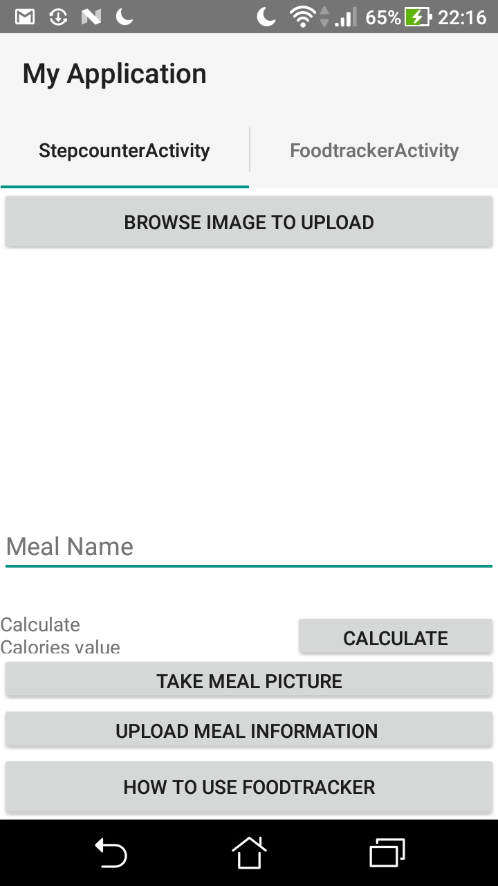

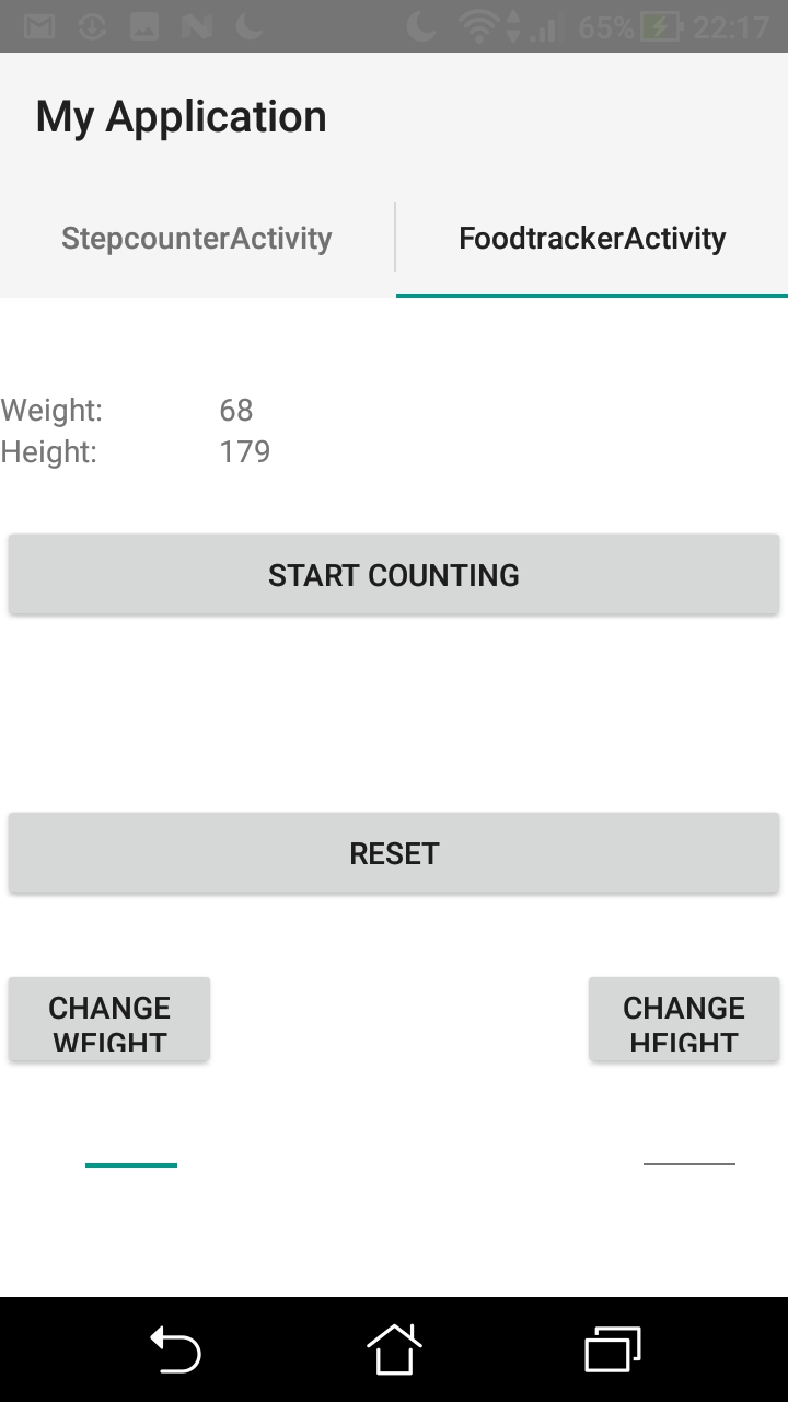

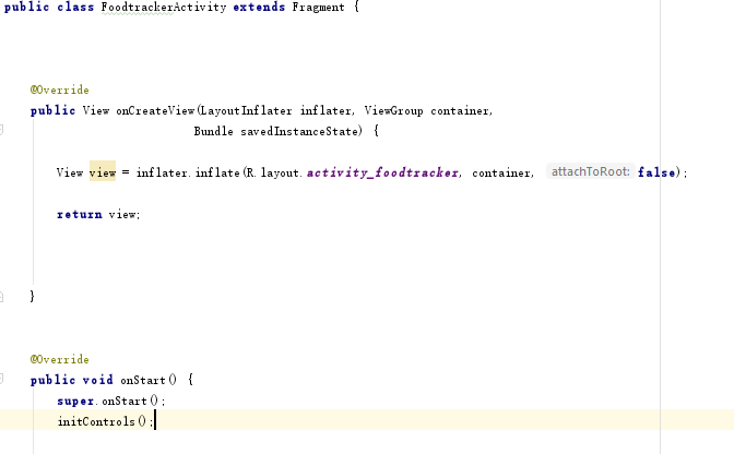

I'm building an app by using fragment with layout shown below. When i adding java class to tab 1 and tab 2, my app work as normal which allow me to slide between tab 1 and 2. When i try to add my third class into tab 3, there is an error appear which state that it cannot extend 2 class at once. Can anybody help me to solve this problem?
The first picture is code use for tab 1
The second picture is code use for tab 2
The third picture is code use for tab 3
The last picture is layout of my app

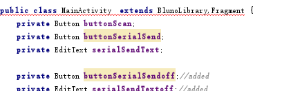

Java does not allow to extends two classes. You can implements as many interfaces as you want, but extends one class only.
That mean there is no any solution for this problem and i need to give up this fragment design and design my app in other way?
Yes, you should rearrange your classes and interfaces according to Java requirement "inheritance is possible from the one super class only".

MainActivity never should extend Fragment. It always must extend AppCompatActivity.
All the tabs should extends Fragment.
MainActivity should start and open first tab based on Fragment by default.

Let me made a clearer explanation. First of all, i have create 3 activities in my android studio, which is MainActivities, FoodtrackerActivities and StepcounterActivities. I can move from one activities to other by using button. But the layout is not so beautiful. So i decide to put all of my 3 activities into fragment, so that i can swipe between them with a more beautiful layout.
As we know, to put activities into fragment, we need to extend these activities with fragment. For the FoodtrackerActivities and StepcounterActivities, it is work when i try to extend it with fregment. Below is how it look like in my app.
So, now what i want is to put the third activitiy (MainActivity) into fragment, But when i try to extend MainActivities with fragment, it show an error.
So my problem now is how i can solve this problem found in MainActivities
This is my MainActivity code with problem which cannot extend fragment

The problem is you are going to extend Fragment and BlunoLibrary at the same time.
Why do you extend Bluno? Is it possible to create instance of BlunoLibrary Class and put it as a field inside of DeviceActivity class?
Is it possible to use interface of BlunoLibrary instead of class BlunoLibrary.
And could you please provide link on BlunoLibrary.
The DeviceActivity is used to collect data from my electronic device built, so it should extend BlunoLibrary (library use to connect my device known as bluno beetle with app build).

To solve you problem you should thrown one of classes which your DeviceActivity inherits.
I suspect you use this code for BlunoLibrary https://github.com/DFRobot/BlunoBasicDemo
As you can see BlunoLibrary Class extends Activity.
So you have three choices.
1. Extend BlunoLibrary Class from Fragment (instead of Activity) and replace Activity UI methods (onCreate, on Start...) with Fragment UI methods (onCreateView, onStart...)
You will get DeviceActivity extends BlunoLibrary, BlunoLibrary extends Fragment
So, your DeviceActivity will actually inherit both and Java rule will be not violated.
And yes, UI methods of BlunoLibrary will be redefined by UI methods of DeviceActivity and you
will need to cope with this.
May be better just extend BlunoLibrary Class from Fragment, replace methods and use it instead of DeviceActivity Class.
But if you are going to use BlunoLibrary multiple times you should use next variants 2 or 3.
2. Rewrite code of BlunoLibrary class and separate Activity methods (onCreate, onStart, OnResume) from Bluetooth processing methods and fields.
After that you will get User Class Bluno, that does not have superclass. You can insert Bluno object inside any Fragments as a field and use Bluno object and methods for connectivity to device.
3. Separate Activity methods (onCreate, onStart, OnResume) from Bluetooth processing methods and fields.Create Bluno Interface, which define methods for connectivity. Impements it in your Fragment and move code for Bluno inside the Fragment.
I think it's better but complicated to separate BlunoLibrary from UI and use it further. Author made mixed version for demo purposes.
This is an example where it has been done https://github.com/mibcxb/BlunoLibrary
Here Bluno interface used for User class BlunoBase. BlunoBase class does not have Activity as a superclass and used by BlunoManager like common user class.
Ya u r right sir, i taken the code from https://github.com/DFRobot/BlunoBasicDemo. But i still dont have any idea about what sir say. Sir u mean u prefer me to use third method by give away my BlunoLibrary class and replace it with BlunoBase class and BlunoManager class?
I would prefer 3rd method. But for you simpler is 1st method.
Take BlunoLibrary class, extend it from Fragment and try to incorporate into project.
So sir from ur point of view, i need to extend BlunoLibrary class from Fragment, how about my DeviceActivities, no any change on code is needed?
If you extend BlunoLibrary from Fragment, you must use it in your Viewpager as a Tab Fragment Activity.
In this case DeviceActivity is removed from project and code from DeviceActivity merged with BlunoLibrary code.
BlunoLibrary will be used instead of DeviceActivity and DeviceActivity is removed from project at all.
I think this is the only way.
I get what u say sir, but it is really complicated, i need some time for that
