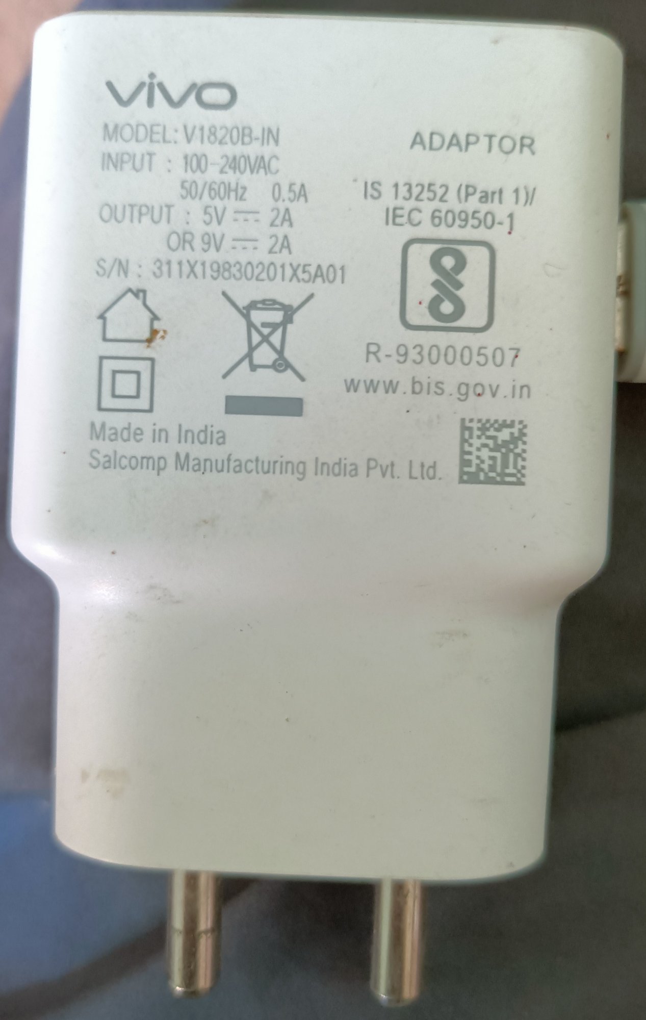

1. Power (W) = Voltage (V) * Current (A). Knowing the maximum input power (watts) supported, one cannot know the maximum input voltage supported. The example given by Fox Mulder is where the charger has options of 9V or 5V output [Image attached] , so maybe you can use the term "backwards compatible" for such chargers where the charger will be automatically set to 5V output for phones which support only 5V input charging. But, as an example, if the charger has ONLY 9V or 12V or 20V output and the android phone has ONLY 5V input charging supported then this will damage the battery.
