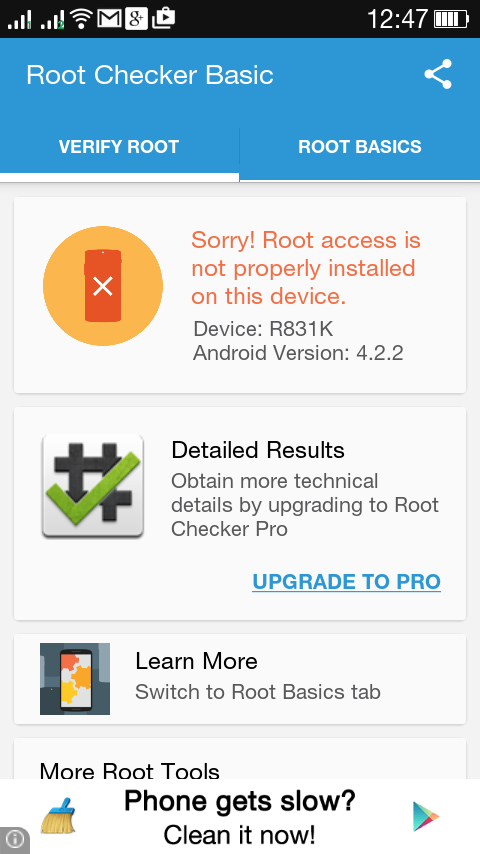

my fon is oppo neo 3. iv rooted it using root genius and unroot it using kingusers.
the problem is when i use root checked its say " your not properly rooted.."
how i can fix it?? pls help me.. kinda frustrating right now and i dont know what to do??

Do you have a SuperSU or Super User app installed?
Once rooted, either of those apps are needed to grant other apps root access. If they're not installed, apps which require root won't work & root checker will think your device isn't rooted.

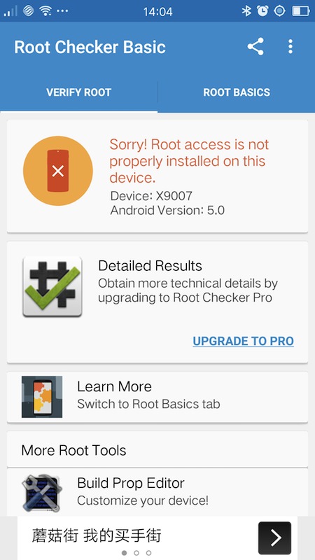

Your Oppo:
screenshot_2015-06-16-12-47-01-1-png.89305
My Oppo:
My phone is NOT rooted
, because that's the way I want it at the moment. :thumbsupdroid:
