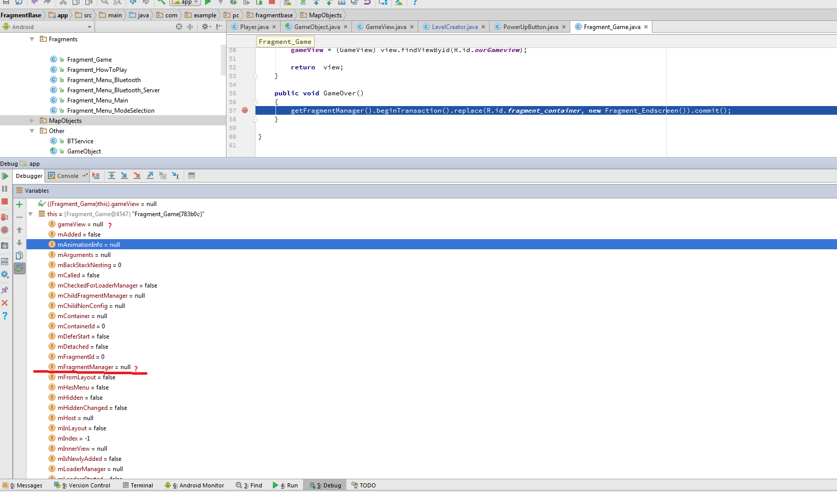

It looks like its the fragmentManager that are null?, however you can see from the attached image that my gameview class is supposed to be null aswell, but i doubt thats it as the code should have left the gameview behind at this point and shouldnt need it to swap to endscreen_fragment.

I'm slightly confused about your code because normally Fragments are managed by the parent Activity, not the individual Fragments themselves.
If you wish to swap out one Fragment for another then this should really be handled by the Activity.

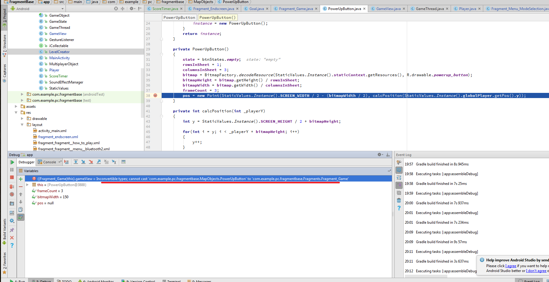

However i get an error that says : Inconvertible types; cannot cast 'com.example.pc.fragmentbase.Other.Player' to 'com.example.pc.fragmentbase.Fragments.Fragment_Game'
Is this an error you have seen in this context before? Ive familiar with the error but in regards to fragments im not sure what has happend.
Im not really getting much information i can post from the logcat or debugger, just this. Also now im getting the same casting error, just on a button object, which makes absolutely no sense to me as it wants to be cast into a fragment_game for some reason. I wonder if you could be interested in fixing the error for me for a price? i bet its pretty simple if your experienced with fragments, and im starting to panic here, i need to have the project done tomorrow afternoon, and im getting nowhere with this last problem :/
That error does not relate to the line of code you're highlighting.
I suspect that the line
Code:
((Fragment_Game)this).gameView = ...
is located in your PowerUpButton class, which would cause your incompatible type conversion error.
Well I'm fairly stumped here, because somewhere in your code you have a ClasscastException.
This would become apparent as a runtime error in your Logcat.
