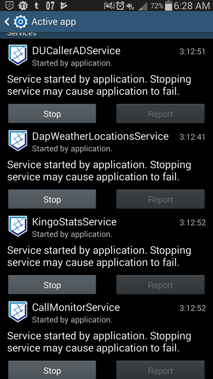

How can we remove the bloat ware that comes with this app?

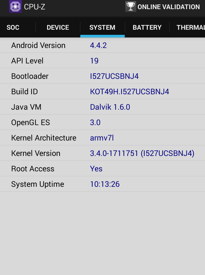

ROOTED SAMSUNG-SGH-1527★Android version 4.4.2★Baseband version l527UCSBNJ4★Kernel version 3.4.0-1711751★Build number KOT49H.I527UCSBNJ4

FYI, DUcallerADservice, that's Baidu advertising, which is something you absolutely DO NOT want on your phone. Of course that's how Kingo Root is "free" and is monetized. If you're not in China, anything DU is best avoided like the plague.

As you used the word 'freeze' I'm assuming you're referring to the popular app, Titanium Backup. There's a free version and a low cost pro version (well worth the cost BTW) and along with advanced backup functionality it will allow you to 'freeze' or 'defrost' apps and background services, giving you the ability to freeze specific items to either just render them inactive or determine how relevant or necessary they actually are. In your situation, you can use TB to freeze those annoying Kingo services and see how that works out before actually removing them. If your phone becomes unstable with those items frozen, just use the defrost option to restore them.

A supplemental option is to install a good firewall app and block those Kingo services from any WiFi and any cellular connectivity. I'll recommend AFWall+, it has a really good feature set and nice user interface. It's probably a good idea to install this whatever the situation as it gives you control over what apps can and cannot get any online access.
