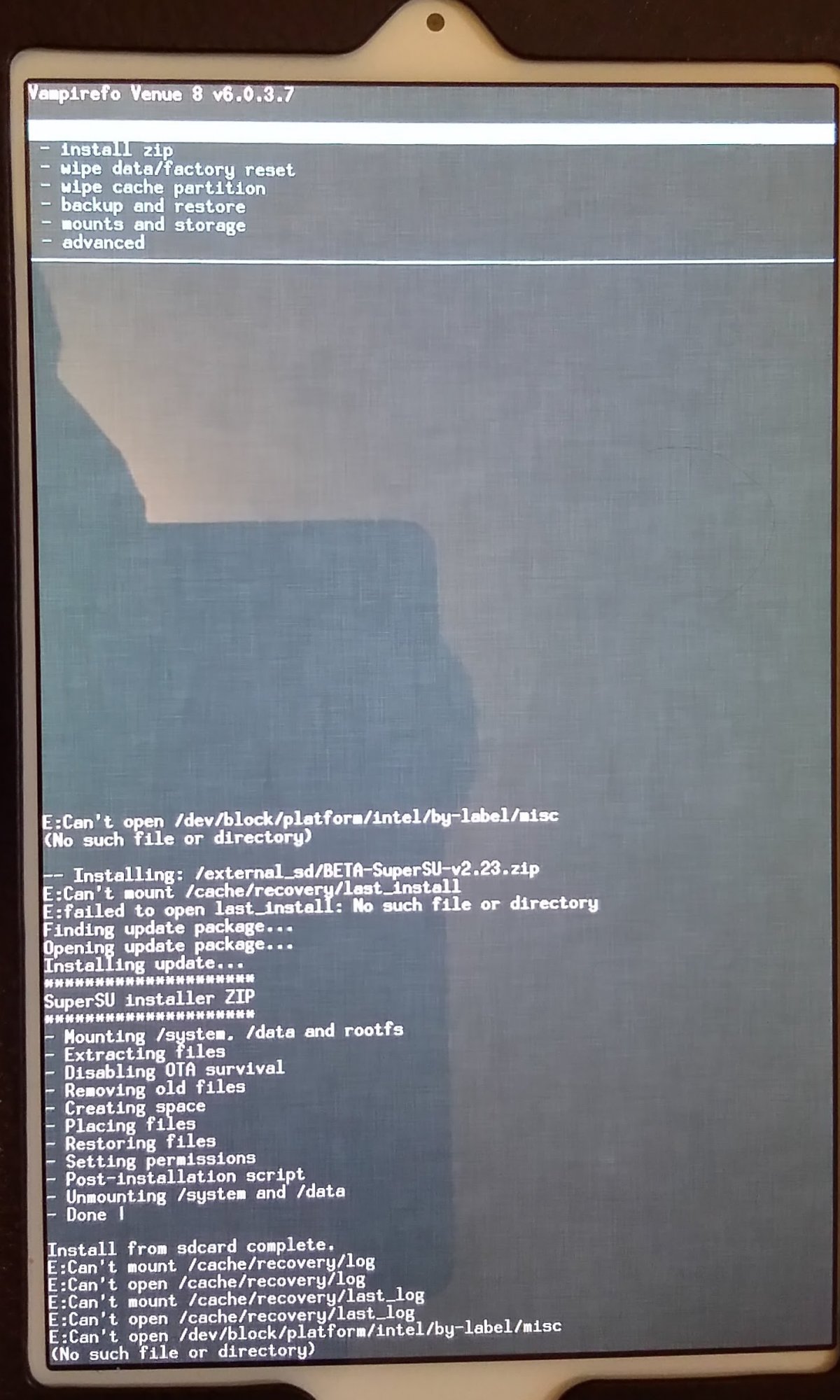

I was able to run the commands under ubuntu 16.04 and install SuperSU from external SD card .zip file. However, after rebooting there is no superSU app, and the Root Checker app tells me that I do not have root access.
The CWM says SuperSU install was successful, but I also see some error messages (screenshot attached):
E: Can't mount /cache/recover/log
E: Can't open /cache/recover/log
E: Can't mount /cache/recover/last_log
E: Can't open /cache/recover/last_log
E: Can't open /dev/block/platform/inter/by-label/misc
(No such file or directory)
I tried formatting the SD card using FAT and FAT32, but the same issue remains.
I'd appreciate any advice.
