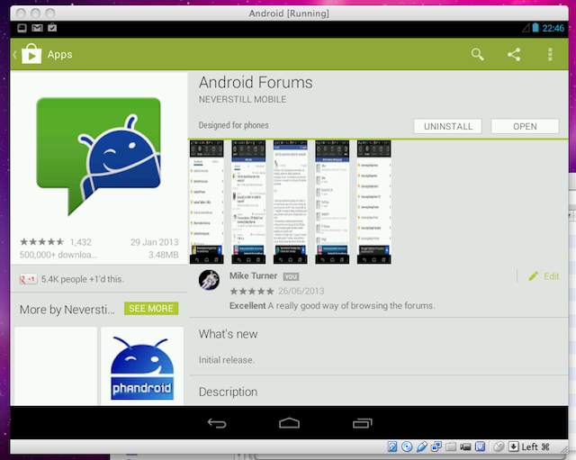

I assume the OP was referring to Android-x86 4.3. It definitely works in Virtual Box and you can install apps from Google Play.

Yeh it did crash my Mac earlier when I first ran it....hold down power switch to reboot. I ran it with Linux > Other, 1GB RAM as the selected VM model, which seemed to be the most appropriate for Android. You have to set the VM mouse options to PS/2, otherwise the Android VM assumes a touch screen, and it can be difficult to control Android without a touch screen. :D
