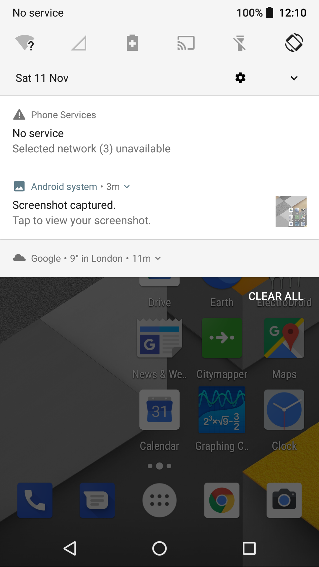

Here is a screenshot:
"Phone Services" is part of the OS? Nearest in Notifications Settings is "Phone" and that has no settings for network availability notifications.
Just a thought: what happens if you set the network selection to automatic rather than selecting 3 specifically? Just wondering because the screenshot suggests to me that you have specified 3 in the network selection, in which case that's one setting which would differ between our phones and hence one thing that might affect this behaviour.
Yes, you are right. When I press "Choose automatically" after "Network Operators" rather than "Search networks" and then pick "3", it no longer notifies on loss of service. Presumably you could try the other way and specifically set your network to see the notifications.
I will try it this way for a bit. However this seems like a bug which is likely to be fixed. If is is SUPPOSED to notify on no service, then it should notify on automatic too once it has searched and failed to find an alternate service. I know it has done this because a (mercifully silent) NO SERVICE message appears in the status bar.
It may consider the lack of service more serious if you have specified that it use that network, e.g. if this prevents it making emergency calls through a different network. That might be the sort of thinking which would lead to a stronger notification in that case (just guessing here).
