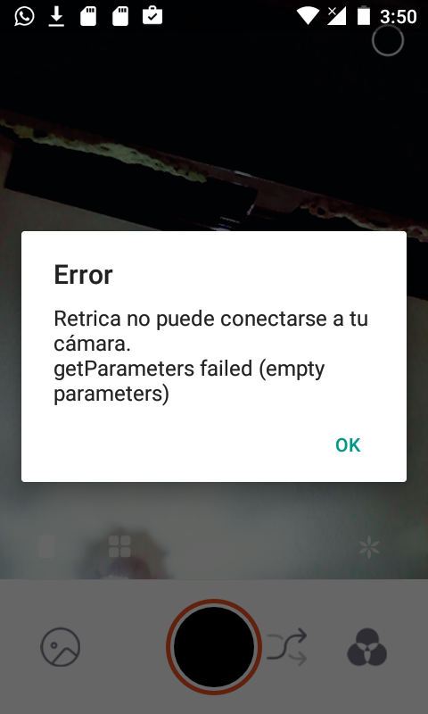

I have this problem in my rear camera of LG L70 do you think this patch you can solve the problem?
Try set SElinux to permissive mode.

To solve the problem of light flares, try the "build.prop" patch.
L70-w5_(patch_to fixing rear cam for any f8 variants)[TuksOID].7z
Extract the 7z file and flash the zip file using the TWRP recovery.

and try switching to permissive mode
And I only detects the front camera, tells me that the parameters do not exist or are empty rear camera
You can help me
I only found these two possibilities. That worked on three devices. Including access problem with the camera was solved with this flashscript in CM14.1. But I'm waiting for the bug fixes to put it in everyday use.
Ex: Dual SIM, is not working in my d325f8. The text editor CMfileManager gives error. BT does not connect. Etc...
What can I tell you?
You have to be pushy when it comes to being a tester, otherwise, you should remain in the version that worked for you.

Thank you brother !, now everything works excellent in CM13 and CM 14.1. D320f8, white spots on the default camera application both third-party applications finally disappeared. !! Congratulations!!

The rear camera started working, with light strips, at the launch of CM13.
Works on CM13 and CM14.1 for D320f8 and D325f8 devices.
Sorry man!
I don't tested in CM13 SnapShot.
Try with some Nightly Version until the 2016-11-07 version.
