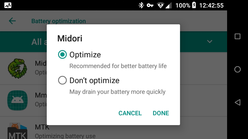

You have to tap on the app after you locate it.
Notice here, how the app Midori is shown as OPTIMIZING BATTERY use...
And then when I tap on it...
you can then see that I am given the choice to OPTIMIZE or DON'T OPTIMIZE.
