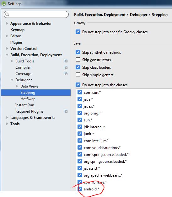

I am trying to debug my own codes, but the debugger starts debugging all system classes e.g. ListActivity.class, Looper.class etc. This makes it almost unusable!
I went into File -> Settings -> Build,Execute,Deployment -> Debugger -> Stepping
... then clicked the button
on the right hand side. I added "android.*" as another "Do not step into class" and restarted A/S.
That didn't work. Still debugging system classes!
A bit of help please ?
