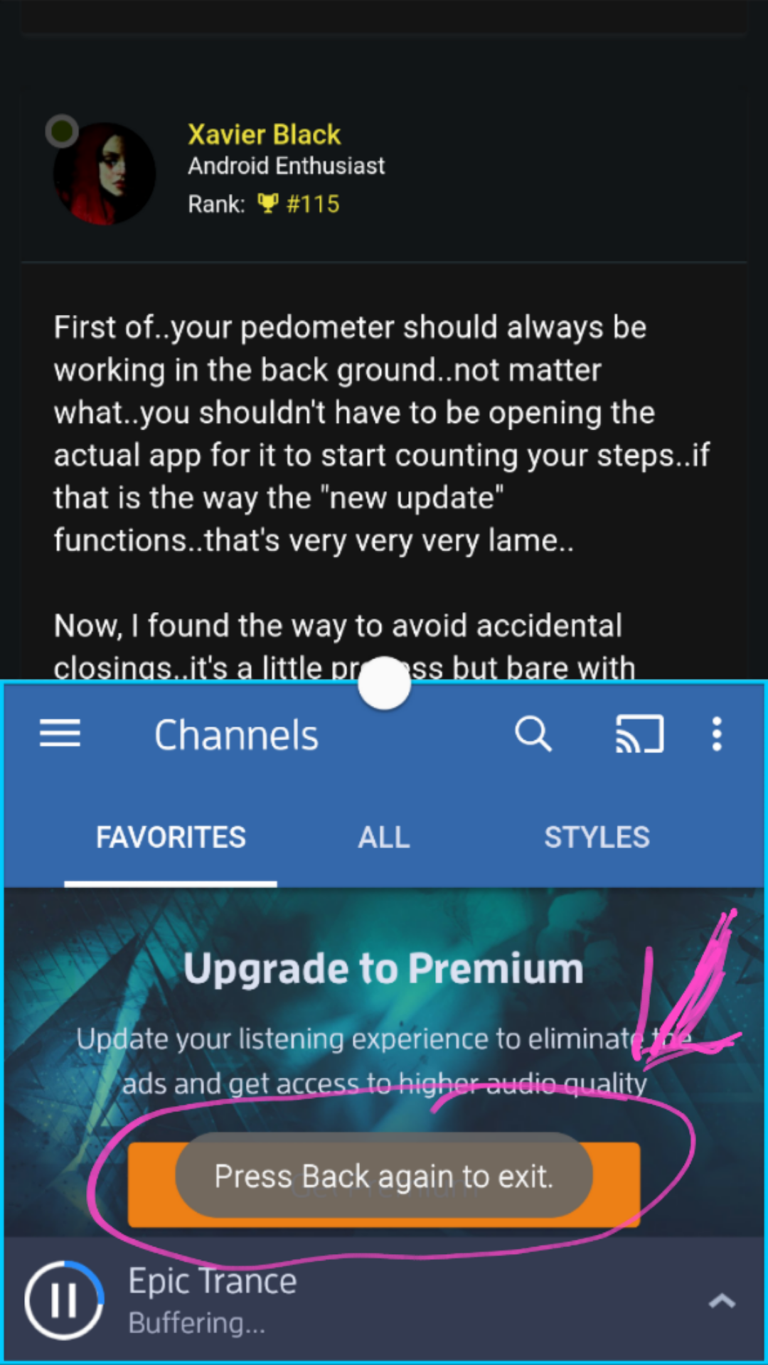

Now, I found the way to avoid accidental closings..it's a little process but bare with me..there's this app called app cloner premium..then when you create the parallel app it gives you the option to it won't close unless you press twice the back button..
Almost all my 65+ apps don't close unless I press twice the back button and if I press the home one they still work on the back ground..
Example of what I'm talking about..
