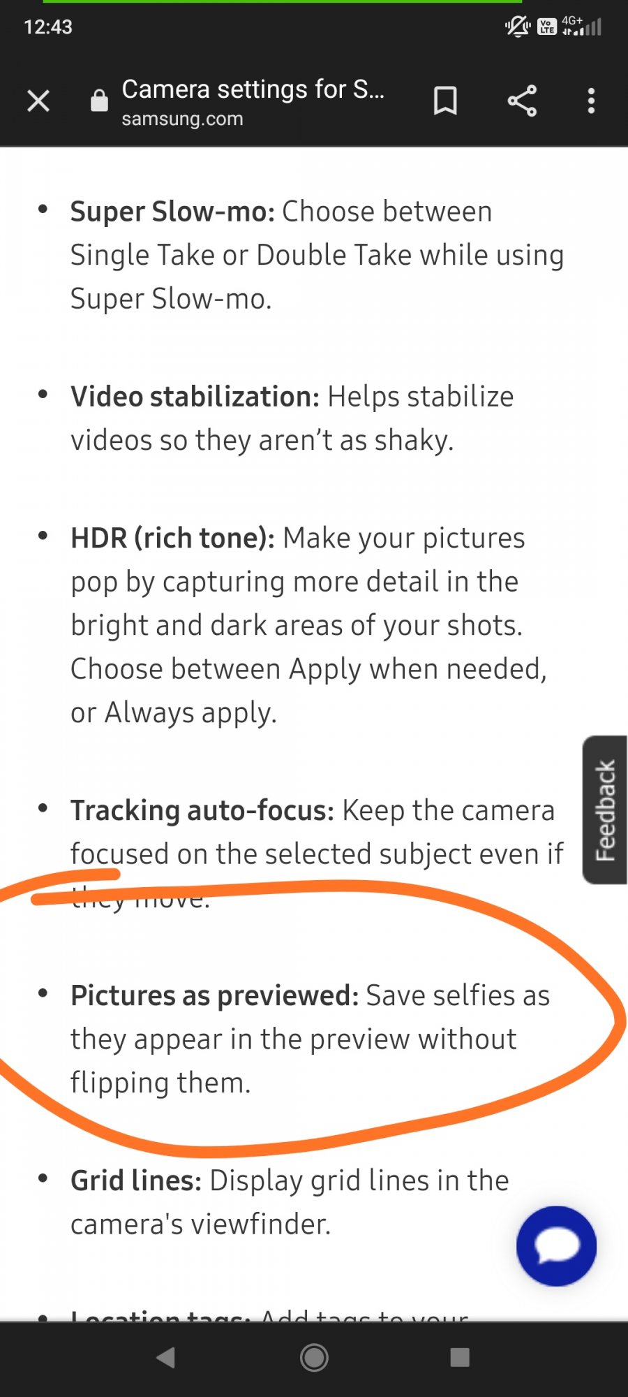

This is all I could find yesterday. Possibly there's two options to flip before saving. IDK
https://www.samsung.com/us/support/answer/ANS00086762/
yes, I double check and the saving option does work for taking selfie pictures ONLY for saving still pictures, but the setting doesn't carry over into whatsapp, or other video chat stuff. looks like hadron might be onto something.
