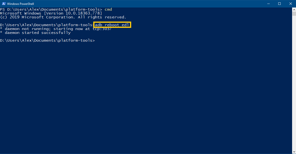

- Using ADB commands, type: adb reboot EDL
Open QFIL, You should see Qualcomm HS-USB QD-Loader 9008 (COM****)

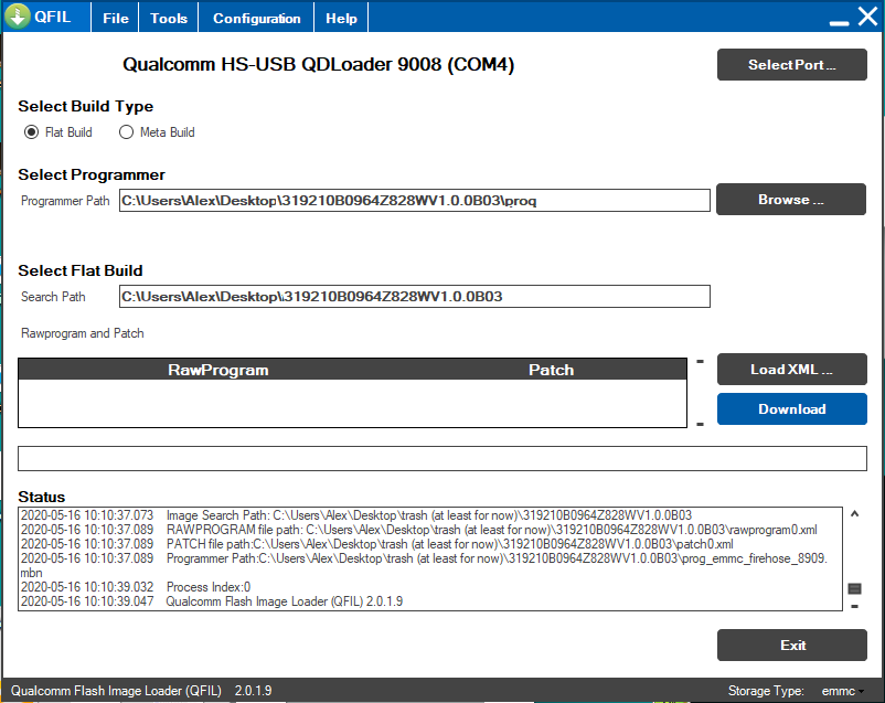

- Select "Flat build"
- Select your firehose (emmc_firehose_8909.mbn)

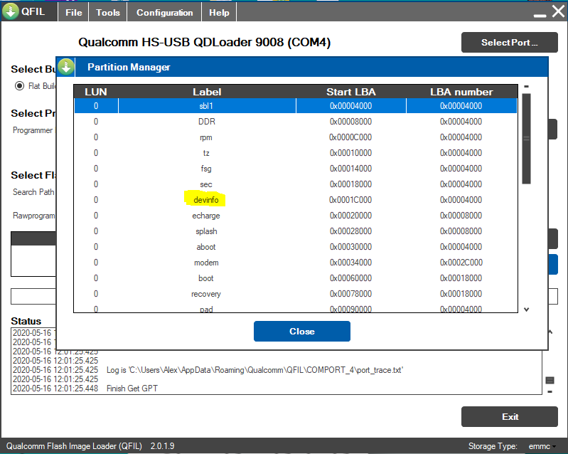

- Select tools, partition manager
- Click ok
- Right click devinfo only and click on "Manage Partition data"
- Click on "Read Data"
- Check the logs on the main window, it will show you where it will be saved (Most frequently in the Appdata/Roaming/Qualcomm folder) and the file will be named something like this: ReadData_emmc_Lun0_0x1c000_Len16384_DT_**_**_****_**_**_**.bin

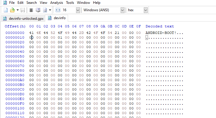

Edit this:
41 4E 44 52 4F 49 44 2D 42 4F 4F 54 21 00 00 00
00 00 00 00 00 00 00 00 00 00 00 00 00 00 00 00

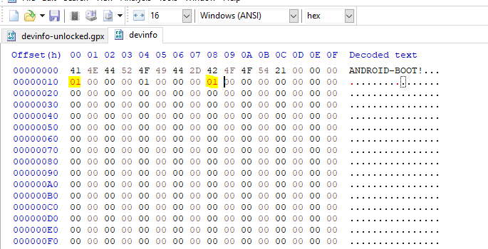

to this:
01 00 00 00 00 00 00 00 01 00 00 00 00 00 00 00

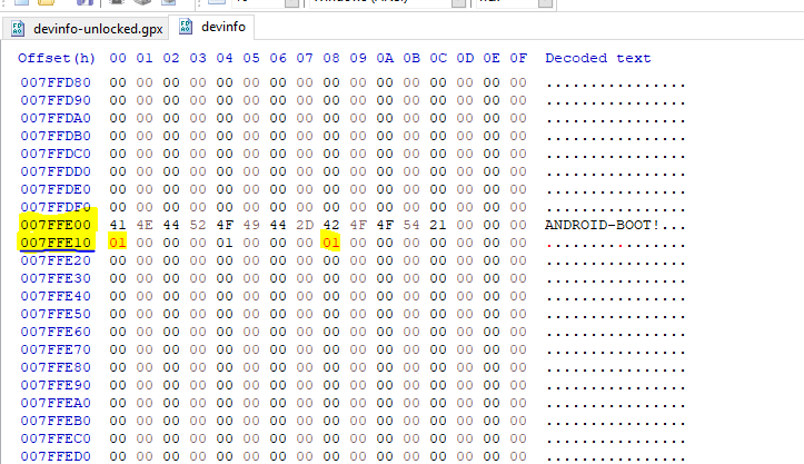

- Go to offset 007FFE00 and repeat the same steps:
