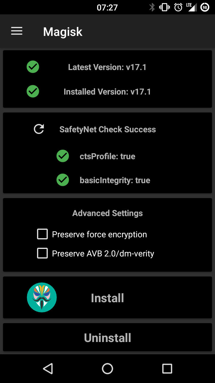

Magisk will help you to pass google's safetynet.Since it stores all the modification in boot partition it may be helpful to you
I tried now but it still fails to pass SafetyNet check:
ctsProfile: false
basicIntegrity: false
I wonder it is due to the fact this is a custom ROM. Even Magisk couldn't help to pass it.
Magisk hide does not work properly either. I checked the targeted app, went back and returned. The check mark is removed.
