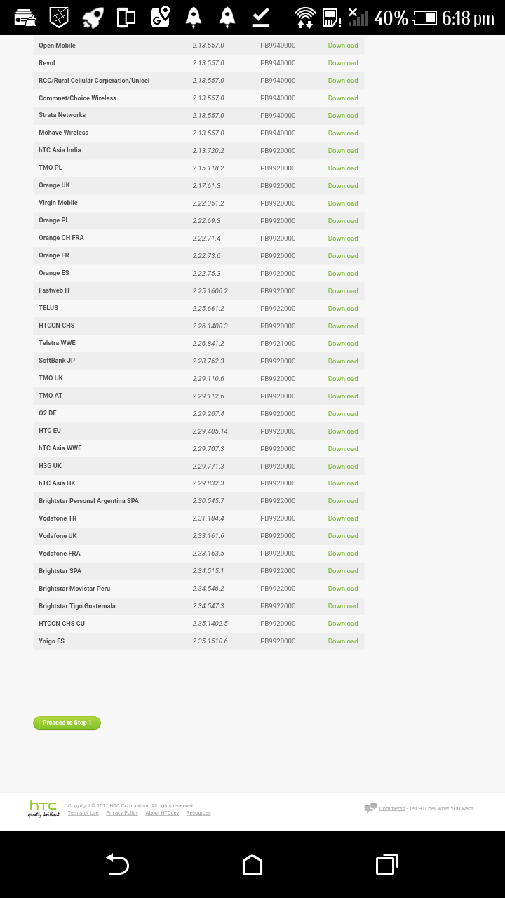

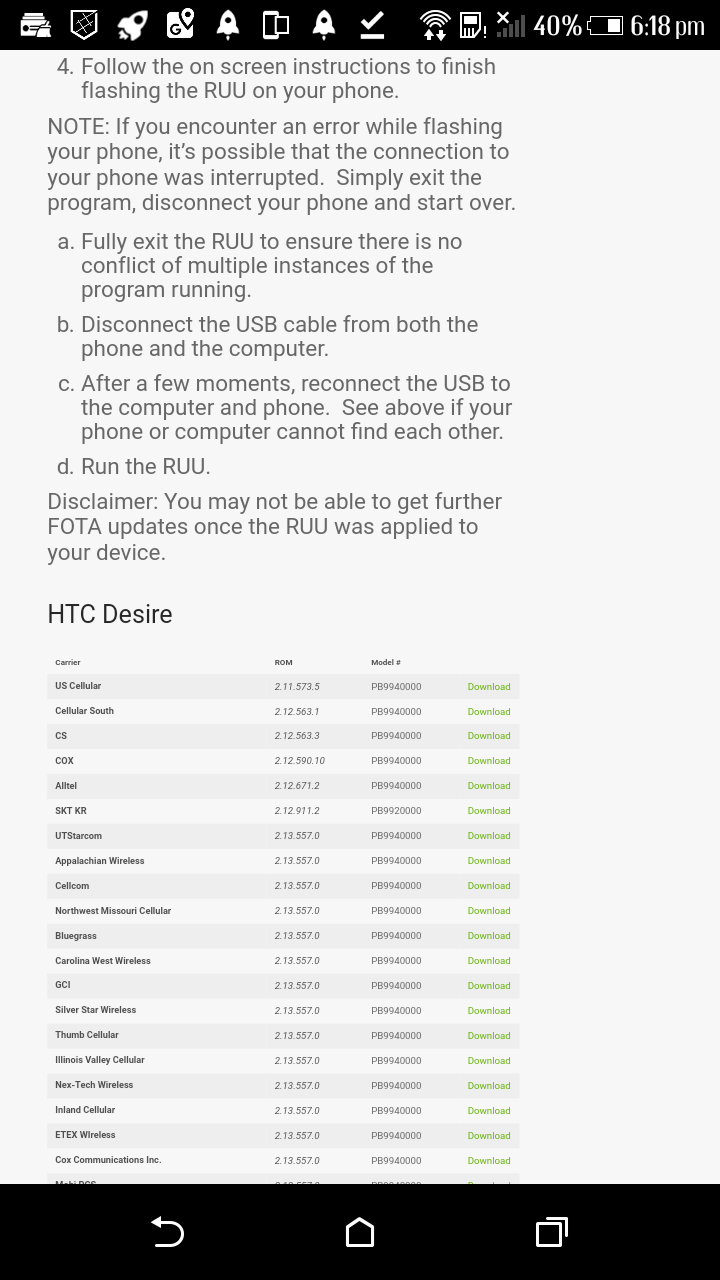

It gives me some instructions that I don't understand on how to do an upload.  It says to find the ROM version in the table below and click on the RUU to download it I don't know where to find them

Did you click on the "HTC Desire" link? That's where I'd expect it to tell you to choose an RUU, and isn't what you want.
