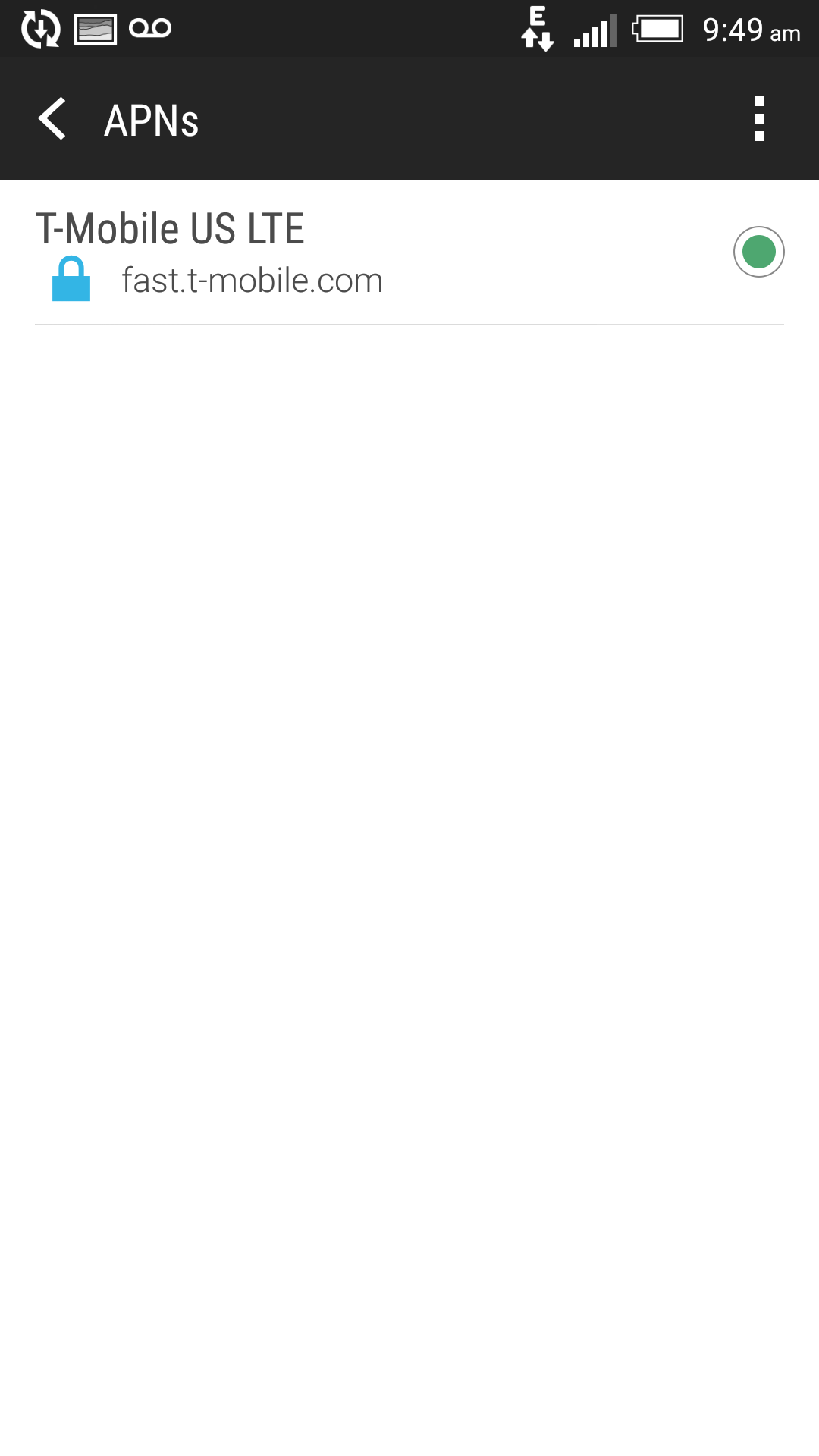

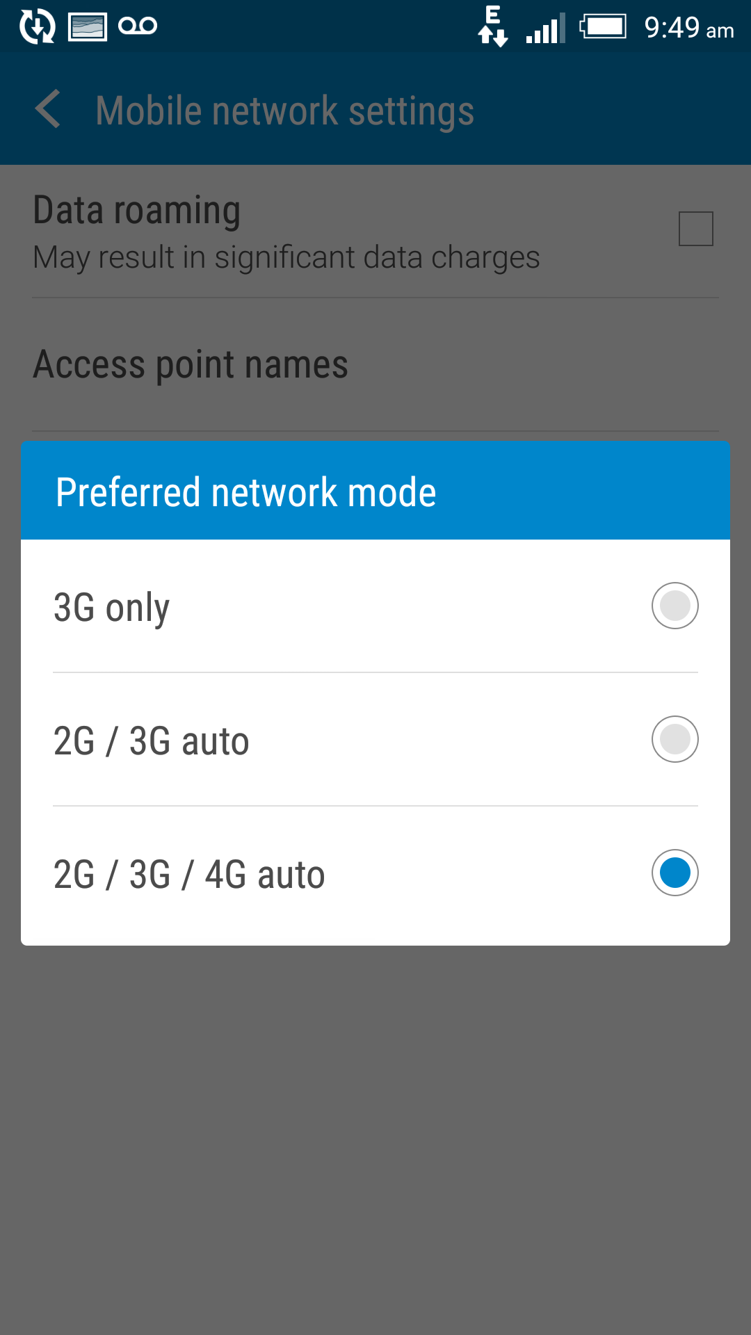

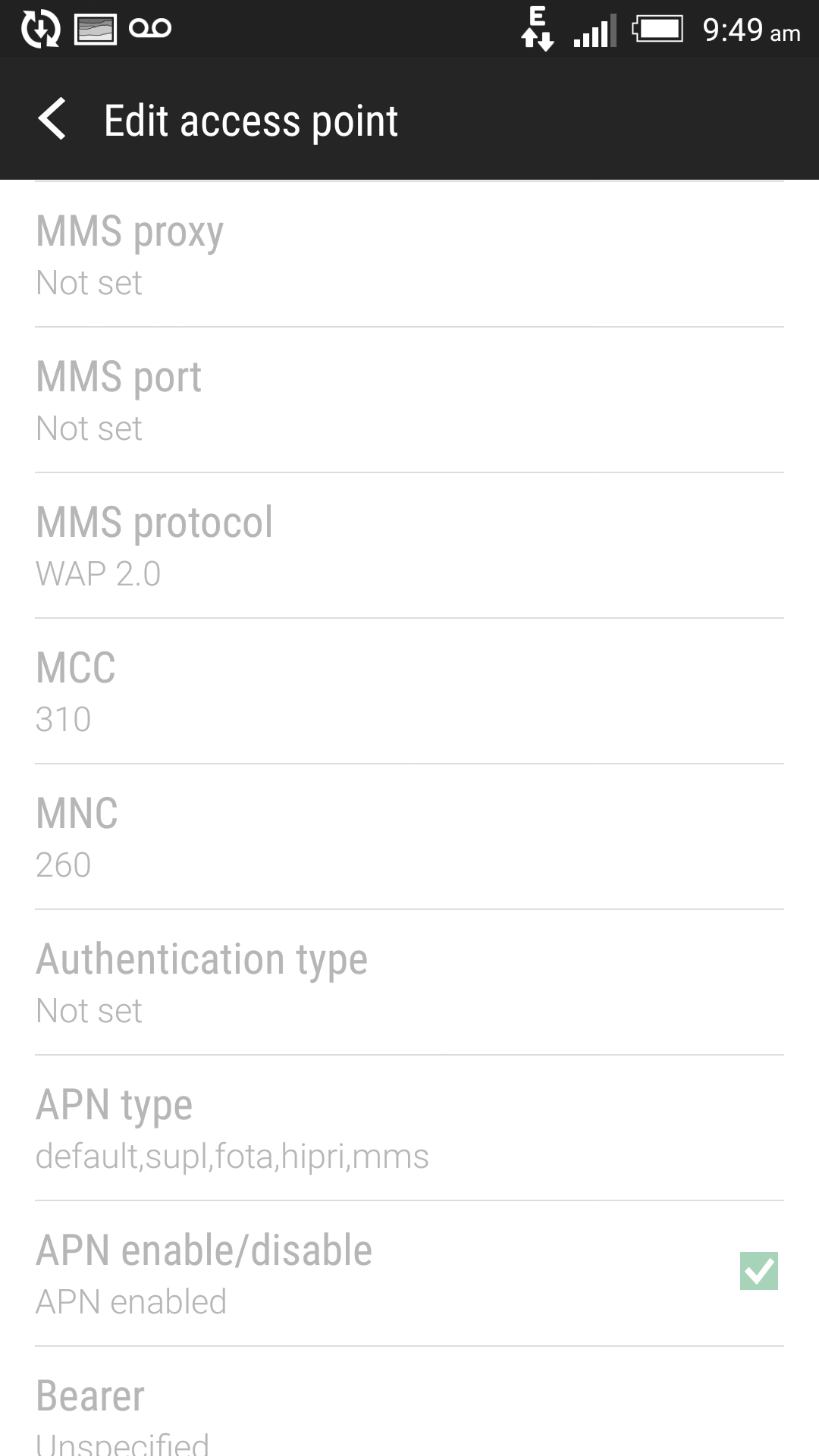

I recently purchased the HTC One M7 (because it was the blue variant and I wanted it). It's network unlocked and to my surprise the bootloader says S-Off. It seems to have the latest Android update available for it, 5.0.2. Everything works perfectly on it with the exception of LTE. I placed my T-Mobile SIM card and all I get is EDGE. I don't even get 3G. The network mode is set to 2G/3G/4G auto. I still only get EDGE. The only APN listed is "T-Mobile US LTE" and it can't be edited.

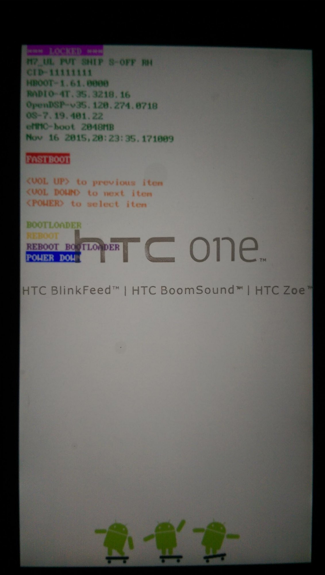

Here's the output of fastboot getvar all
(bootloader) version: 0.5
(bootloader) version-bootloader: 1.61.0000
(bootloader) version-baseband: 4T.35.3218.16
(bootloader) version-cpld: None
(bootloader) version-microp: None
(bootloader) version-main: 7.19.401.22
(bootloader) version-misc: PVT SHIP S-OFF
(bootloader) serialno: FA3xxxxxxxxx
(bootloader) imei: 357xxxxxxxxxxxx
(bootloader) meid: 00000000000000
(bootloader) product: m7_ul
(bootloader) platform: HBOOT-8064
(bootloader) modelid: PN0710000
(bootloader) cidnum: 11111111
(bootloader) battery-status: good
(bootloader) battery-voltage: 3716mV
(bootloader) partition-layout: Generic
(bootloader) security: off
(bootloader) build-mode: SHIP
(bootloader) boot-mode: FASTBOOT
(bootloader) commitno-bootloader: dirty-0e2a13e5
(bootloader) hbootpreupdate: 11
(bootloader) gencheckpt: 0
all: Done!
finished. total time: 0.140s
So I see it says"M7_UL" which supports LTE, but the MID is "PN0710000" which I just looked up and it's supposed to be the European international version. I even went to the local AT&T store and they tried one of their SIM cards on it and it doesn't even get a mobile signal. Does that mean that there's no way to get LTE to work with this phone in the USA?

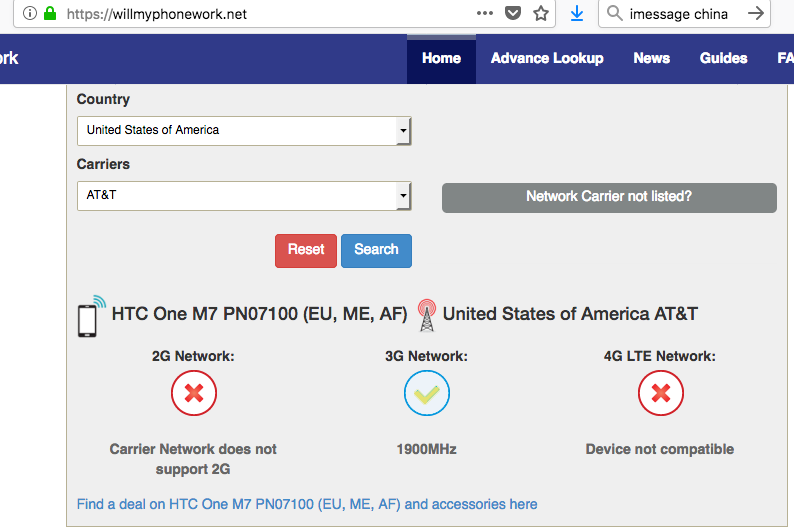

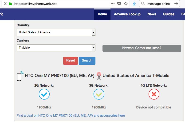

According to https://willmyphonework.net
...that EU variant of the One M7 will NOT support 4G with T-Mobile in the US, and 3G maybe only partial. And I believe AT&T doesn't operate a 2G network anymore. So I think there is absolutely no way to get it to work correctly in the USA.

Well according to willmyphonework.net that "EU" variant of the M7 does NOT support US 4G with either carrier. ME(Middle East), AF(Africa).
And partial support on 3G. Maybe it only works in certain areas? Presumably it doesn't have all the 3G bands for complete support in the US? I would suggest that the Ebay description and vendor are wrong. and you've found out that it doesn't.
See about returning it I think, there's not much else you can do.
I'd have thought you'd get 3G coverage: it should support the 850 and 1900 bands, which are US bands (not sure exactly what T-Mobile use though). No chance of US LTE though, especially not T-Mobile with their split-band AWS setup which back in 2013 was only supported by special T-Mobile variants of most phones.
