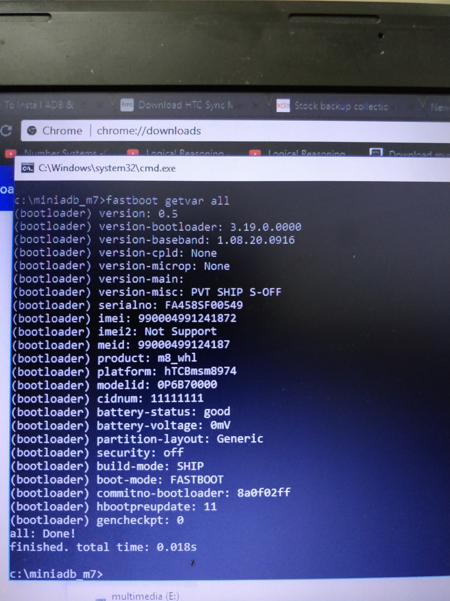

I tried to run the ruu.exe with s-off and relocked bootloader but its giving me an error 102 saying battery is 30% less than required although my battery is 90% charged.
Then i again tried to flash the ruu.zip file through command prompt then it giving an error target reported max download size of 1826418688 but i have 17 gb of empty space.
Then i tried to flash the ruu.zip with twrp but it failed.
Do i need to unlock the bootloader again ? What should i do?

You can't flash an ruu zip using twrp.
How exactly did you try to flash it from the command prompt? Precisely what commands? You can't just use "fastboot flash <partition> zip file", there's a multi-step process, starting with putting the phone into "ruu mode". It's a bit awkward to search up from a phone, but I'll try to dig the procedure out later when I have a computer.

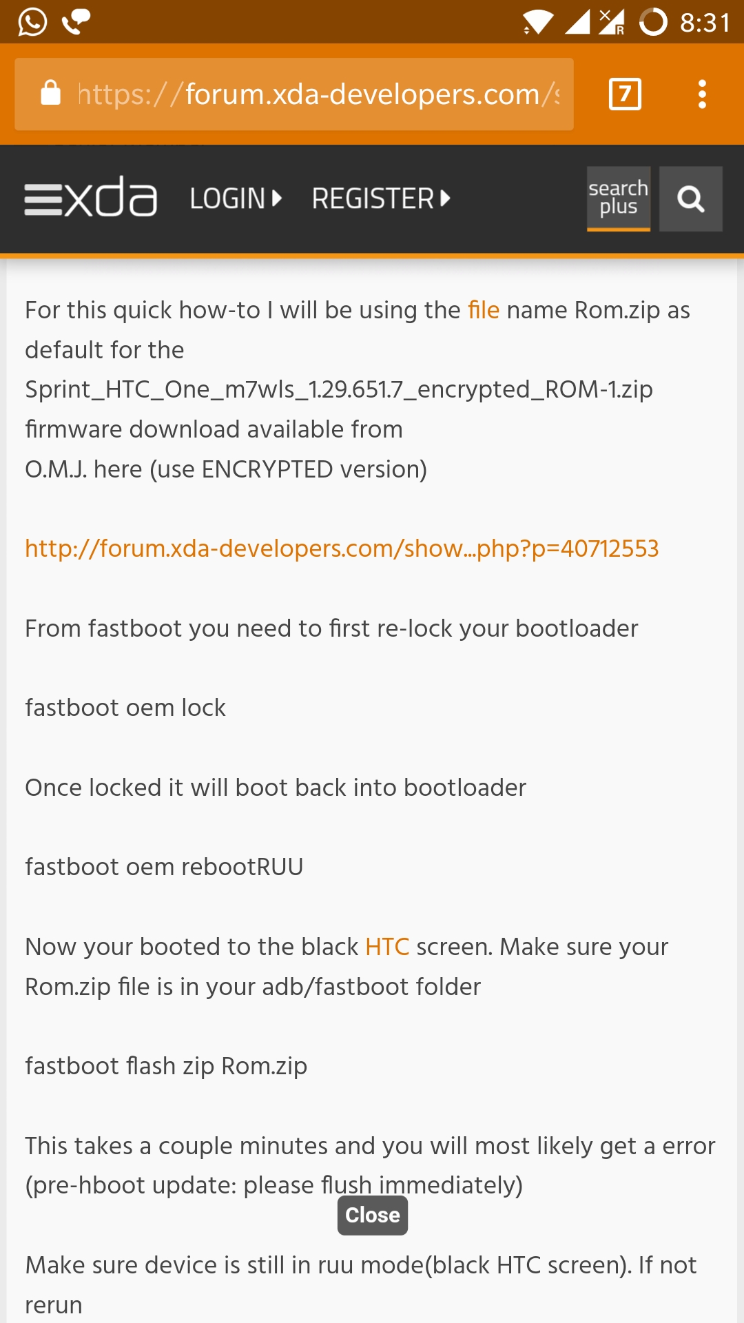

These are the steps which i followed
No worries u can give me the procedure later :)

Hmm, from memory that looks plausible. You have to do the last command twice (the first basically just updates the bootloader) and then the progress bar stops at 90%, leaving you to check for errors and tell it to reboot if not. If that's what the rest of the recipe says then it's probably the right one.
Did it say anything after the "target reported download size" message? I have a feeling that that may be normal and what came next would be the answer.
