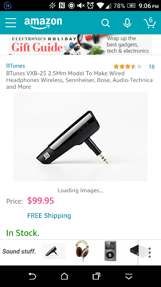

If there were ATH-M50X Bluetooth headphones I totally would.
You can convert your ATH M50X to wireless headphone. There are many howto guides on Internet.
Or you could just buy a set of wireless headphone, the native version usually has its own long life battery and equalizer.
Something like this?
