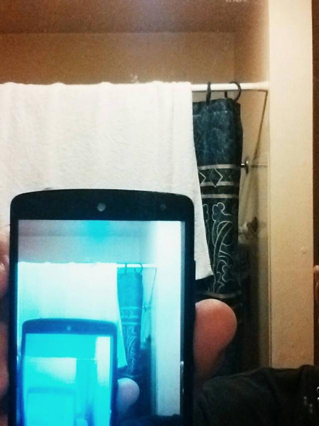

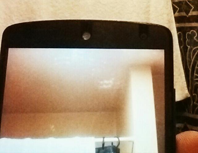

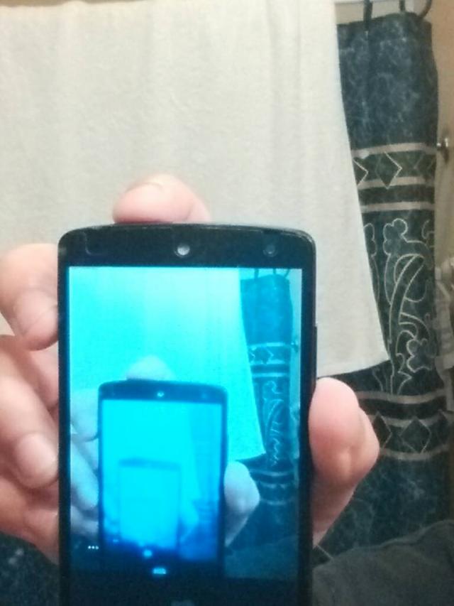

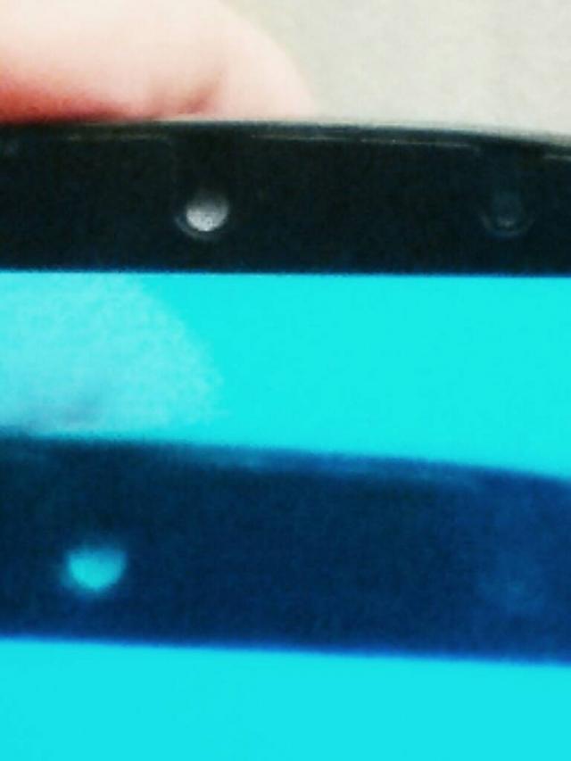

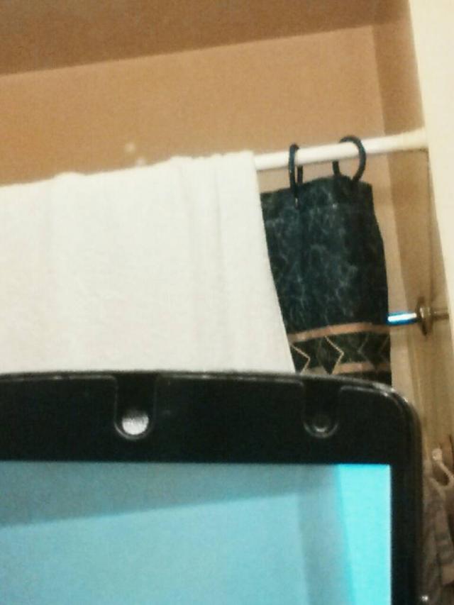

Here are the best pics I could get in a mirror guys. Sold my Moto G on eBay and basically got burned (that's a Whole different, long, ridiculous story lol), so I didn't have a camera handy to take decent pica of it. But now from the front, I think it looks So much better. Some people like the muted black all over, but I love the fact that this happened, as now not only do my calls sound better, my phone now also stands out from every other Nexus (for the moment, at least lol.) Who knows, maybe this will start a movement and get people to start "alcohol-modding" their Nexuses lol. Thanks for the help everyone, I appreciate it! This is by far the best Android Forum site in existence. Anywhere else, people turn into "keyboard-killers," when they act hard and call people names from the safety of their home, protected by their monitor and keyboard, or phone. Sorry, off topic, I know, but I just had to get that out haha. So what does everyone think of the look of my nexus with the nice, unpainted steel grill? And would any of you do it to yours? I know I was always jealous of white nexuses having that damned white ear grill to break up the mundane, plain black look of the front lol. Let me know what you think, and if you will, or would like to do it to yours!!!
