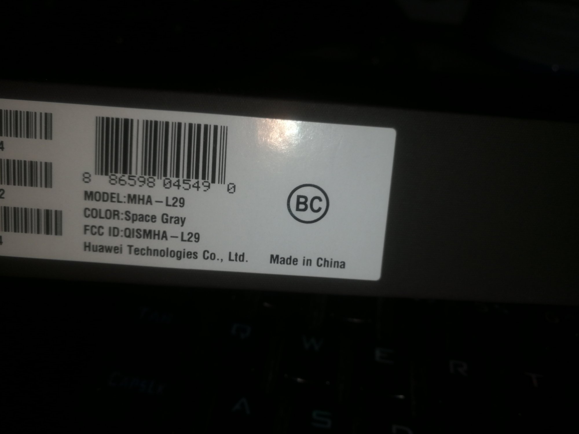

On the rear of your Mate 9, at the bottom, is there "MHA-L00" along with some Chinese wording? If it is, it's actual the Chinese Mate 9 variant that's been unofficially re-flashed with international "MHA-L29" EMUI firmware. I'm pretty sure that won't receive any updates, because it's an unauthorised modification..
The MHA-L00 variant is only intended to be sold and used in China, and I believe there's some unofficial vendors on Ebay, Amazon, and maybe Craigslist as well, re-flashing and selling them as grey imports.
Here is a pic of the sticker on the bottom.
That sticker looks legit as an international variant Mate 9, and should have received EMUI 9 by now. Because China variants have the company name in Chinese, and no FCC ID.
When you say you had to repair and replace the logic board, where did the replacement logic board actually come from? Perhaps Huawei are determining it as unauthorised modifications, and thus no updates are pushed out for it? And what you can do about that, I don't know.
