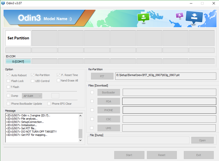

I'm 2 days now busy on cf_root for my s3
But EVERY time i get stuck on "Get PIT for mapping"
Tried odin 3.04 and 1.85
Tried different usb ports/cables
I do have te right drivers but i cant get it to work..
Could somebody help me

man sorry i need your help... i have samsung note 2 and im flashing it but it stucks on GET PIT FOR MAPPING .. changed usb cables like ten diffrent cables. changed usb port all 4 of them im on lap top. i did restart odin since yesterday and repeat process but nothing changed! downloaded PIT files again stil not go through there, used diffrerent versions of Odin still the same problem. now im running out of options. please anyone i need help.
