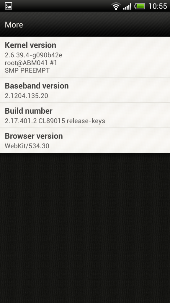

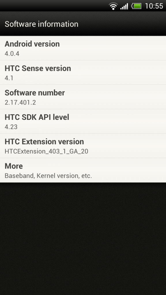

Yeah, after I installed the stock ROM my device was unrooted but then I rooted it by installing Rooting Tools through CWM and then flashing the stock recovery. Yes, the bootloader wasn't affected and remained unlocked.
I installed ARHD17 to try it in the time being until I hopefully sort this thing out. A fellow on XDA told me that I'd need to install a Nandroid Backup with the latest firmware (2.17.401.2) and he gave me a guide with the steps and everything.

since youve updated your firmware,you will not likely be able to apply an OTA. even if you use recovery to flash a completely stock release version ICS rom(not based on a leak) and the updater finds the OTA,it wont apply becasue you dont have the firmware its expecting.
your best bet is to keep enjoying custom roms. they will undoubtedly be updated to the official OTA base as they are released.
once an ruu is released for your CID,you can relock and run that if youd like,to get current release firmware. re-unlock,reinstall recovery,and either flash superSU to enjoy stock rooted,or flash a custom rom,or restore a backup :)
running the ruu is every bit as good(IMO its safer) as getting an update OTA :)
