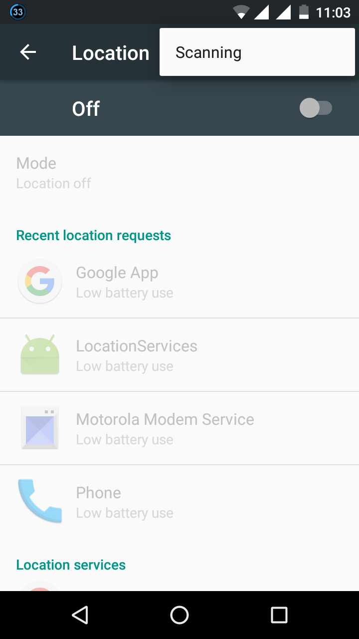

I have had the same issue.
I tried searching for it and found out problem is with location setting.
The following worked for me:
Go to settings/location,
Touch icon on upper right corner,
Then touch SCANNING,
there are 2 options,
1. Turn Wifi scanning On.
Hope this works....
