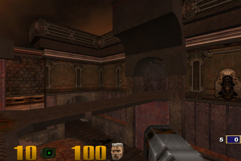

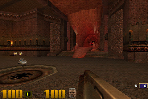

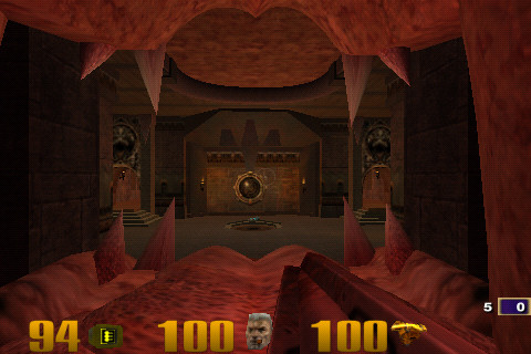

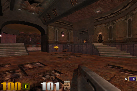

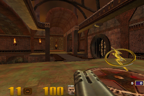

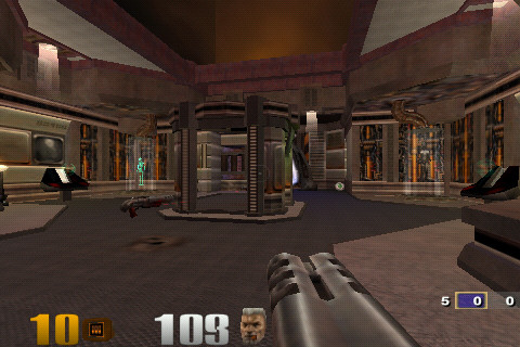

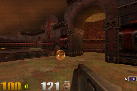

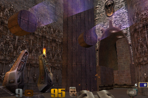

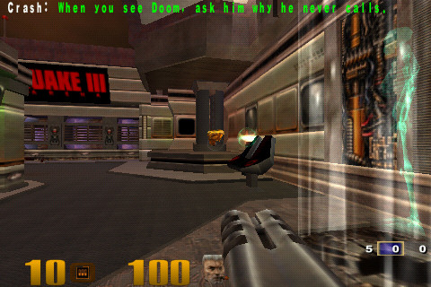

First, a few screenshots for those not familiar with Quake3:
