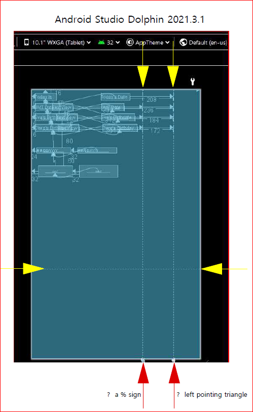

A few years I created a simple app. I don't remember what version of Android Studio I used. The app has worked fine. A few days ago I installed Dolphin 2021.3.1 and successfully walked through some tutorials.
To make some changes to my simple app I opened it. The attachment shows 2 vertical and 1 horizontal dashed/dotted lines in the Layout Editor, that I annotated with yellow arrows,.
Deleting all constraints and dragging the lines away from the area made them disappear.
Question: what did I do to cause the dashed/dotted lines, to show up?.
Thanks,
Bill

This is a PNG version of the Layout Editor, though it is a little blurrier than the PDF.

I discovered the answer.
They are Guidelines.
In the Layout Editor, on the same icon row with the eyeball and U, etc. At the end, in what I see, is something that looks like an capital i.
I didn't knowingly want them.
I deleted them by selecting each and pressing [Delete].
