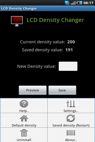

Change the density of your phone/tablet with a click on a button. Comes with a boot monitor that will get you out of situations where a wrong density don't let you into the system.

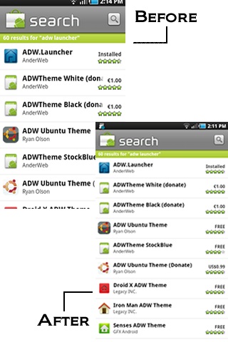

By changing the density you can create a high resolution effect on your screen. The result is that more information can be displayed. For example:
Screenshot of the interface:

Update: now with preview/temp change functionality. Change the density without rebooting the phone.
Preview/ temporarily change the density setting:
  • to check (safely) if your device will support the new density value before saving the new density setting.
  • to play games or apps that require a particular density setting. Keep playing those games you liked with your default density.
  • to experiment with different density settings to see which setting is the best for you.
  • now possible to use for rooted devices without r/w access to the system directory like HTC Desire
