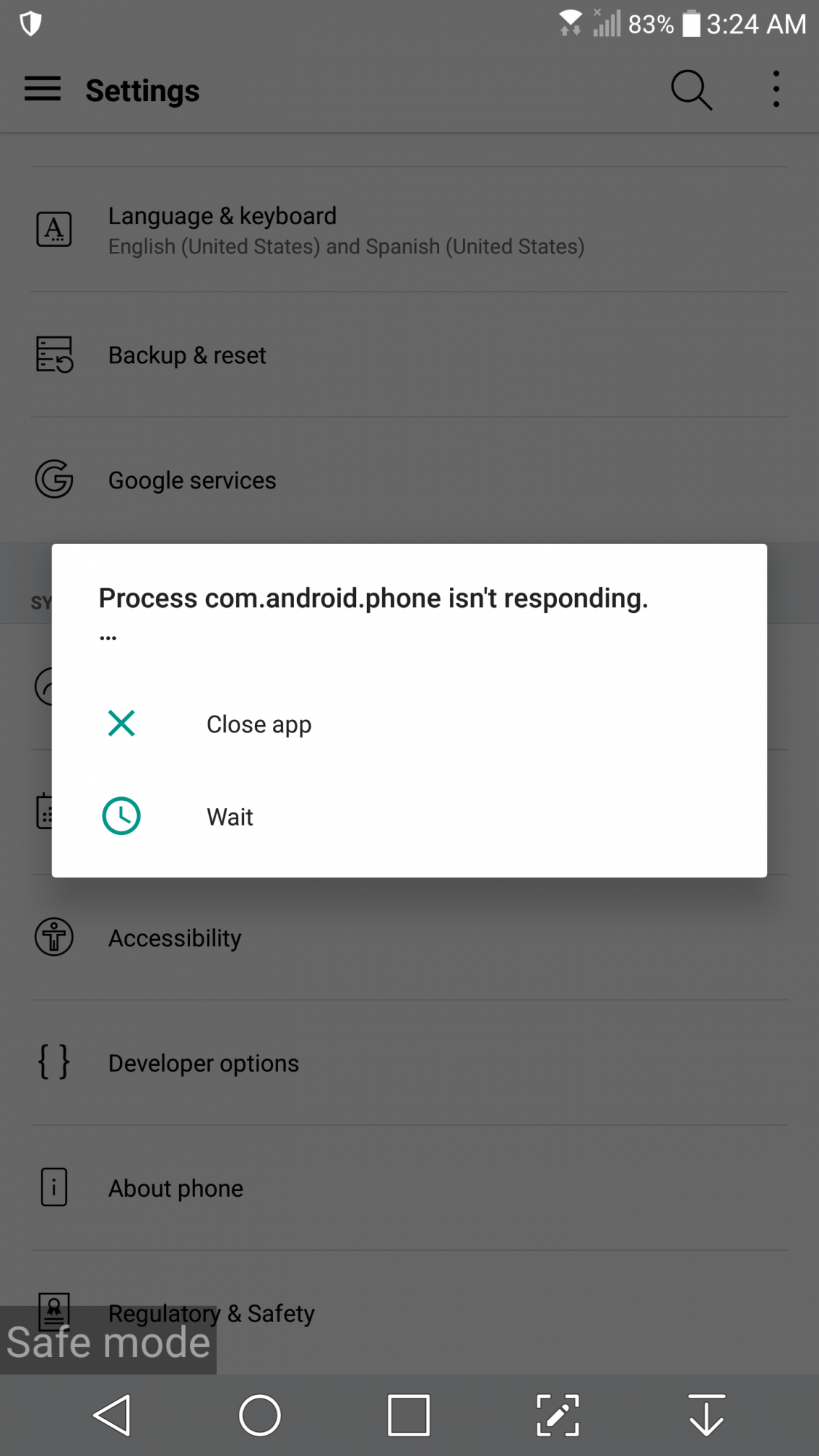

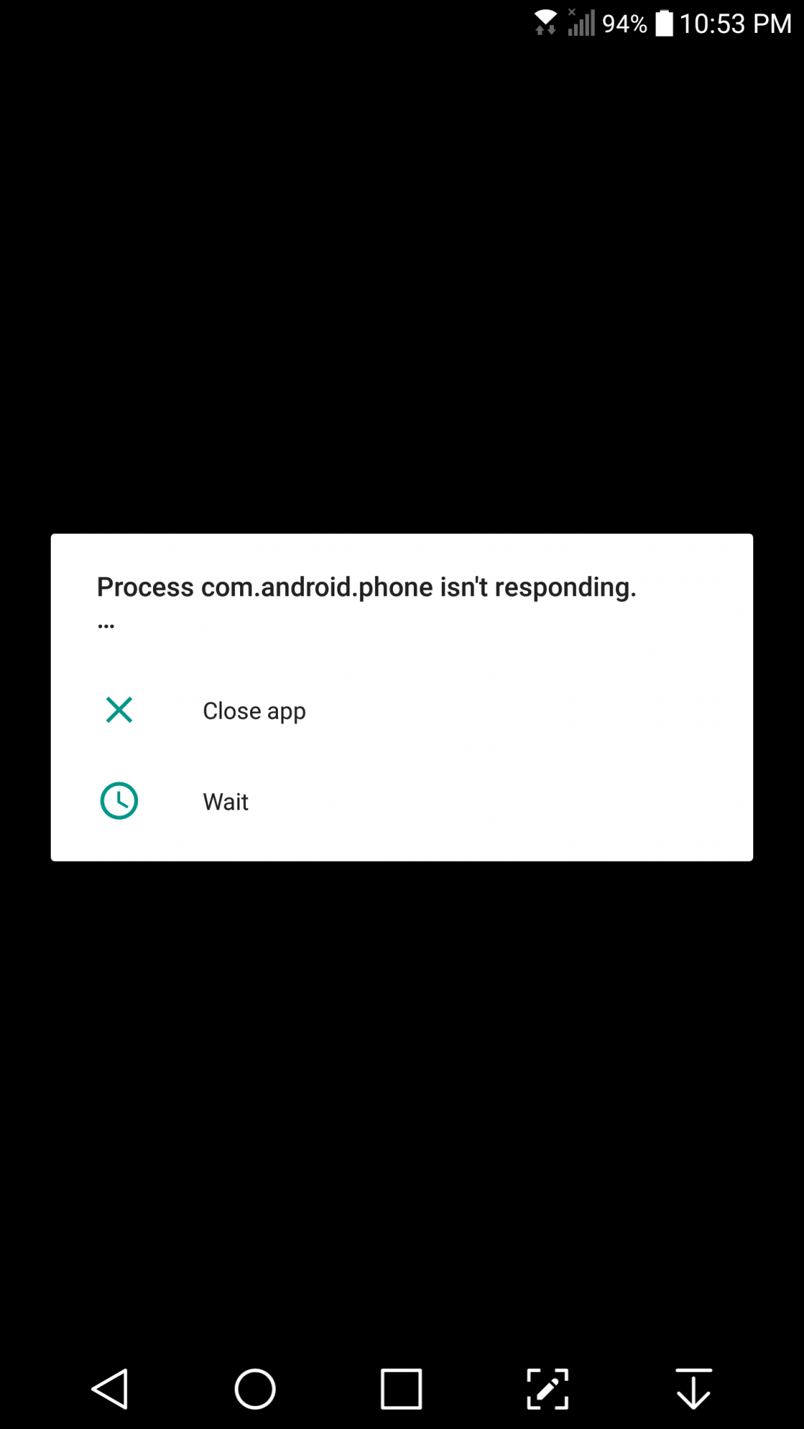

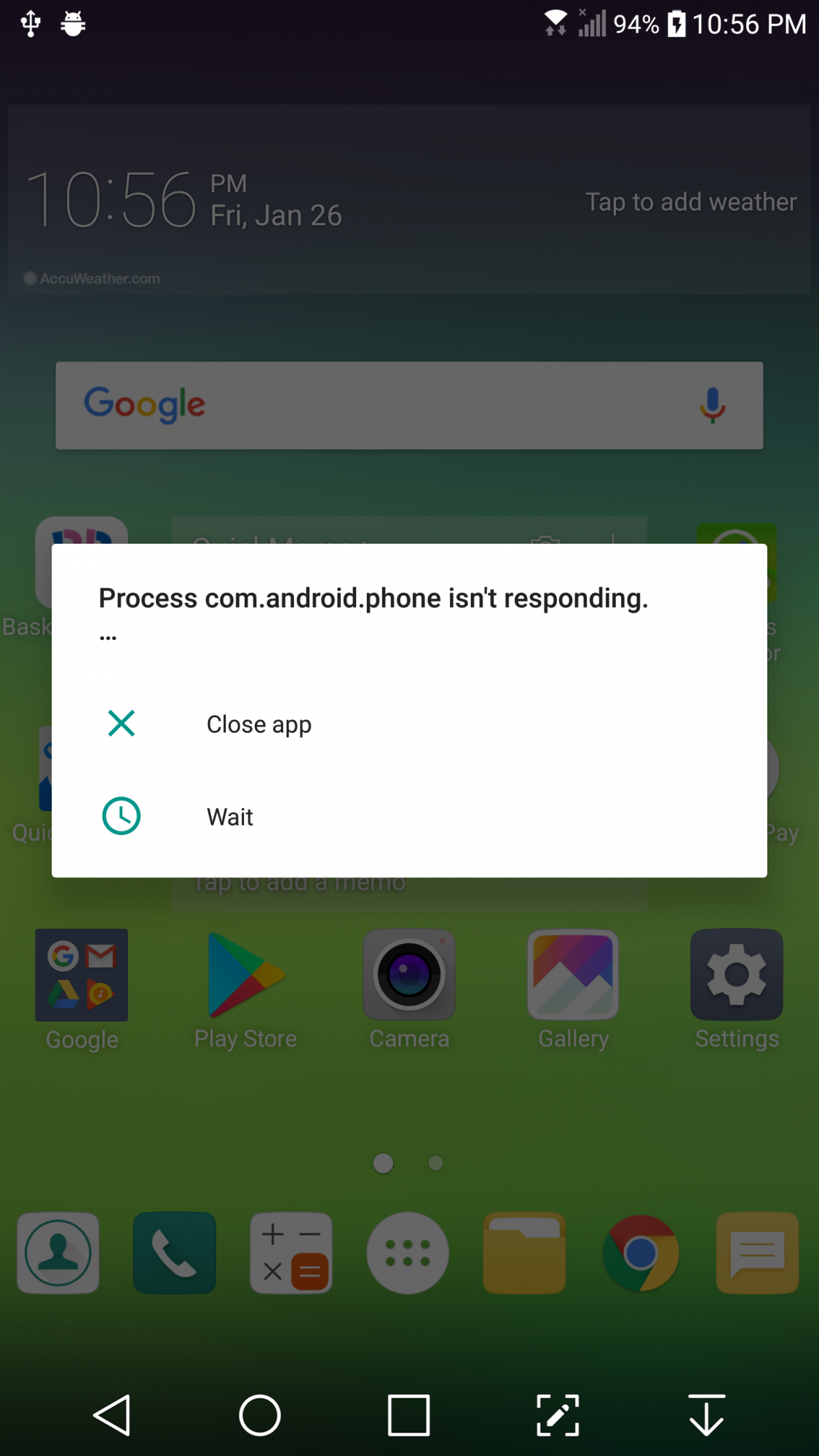

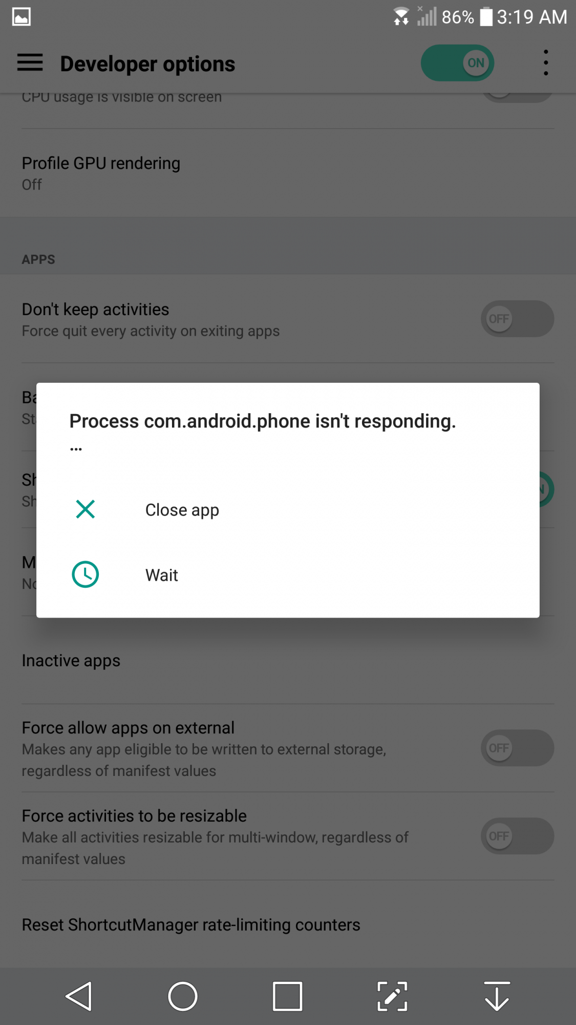

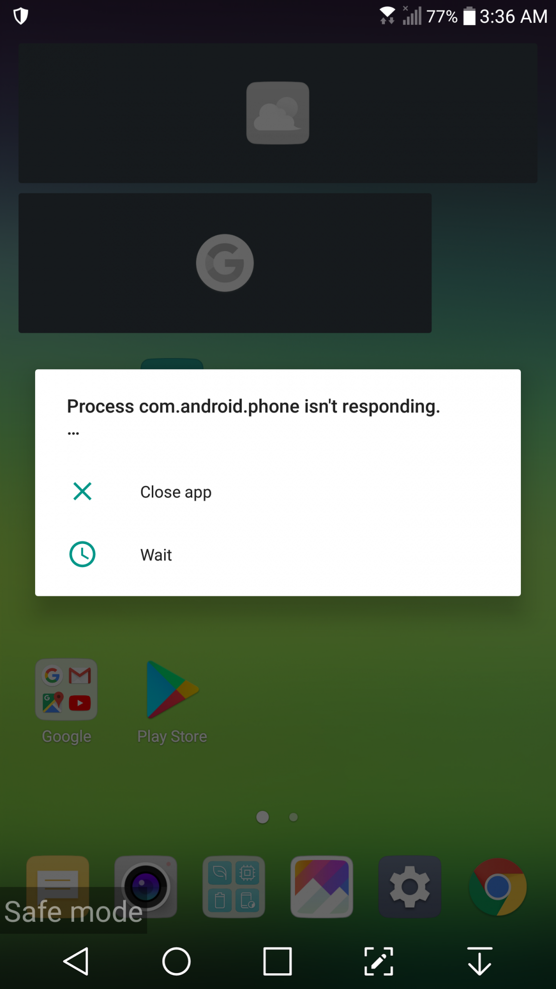

I had noticed some time ago when booting the LG G5 (RS988) into the stock Nougat that I receive an error stating, "Process com.android.phone isn't responding". If one goes to Settings --> About phone --> Status OR Settings --> About phone --> Network, one may see a long delay before any information for section is displayed. The problem manifests both in the normal mode and Safe Mode. The error was not displayed when using stock Android Marshmallow.
I have applied the various LG updates for the device, but the problem persists. Clearing various caches does not resolve the problem. The problem appears to manifest regardless as to whether or not the "Show all ANRs" option from Developer options is used; however, when "Show all ANRs" is not enabled there may be a lag or delay before the device performs some actions while waiting before the "Process com.android.phone isn't responding" error message appears. For the error message to be displayed, the screen should not be allowed to go to sleep prior to the display of the error message. I do not know whether or not the presence of a SIM changes whether or not the problem manifests.
To attempt to reproduce the problem on the device, the following procedure is used on a device without a SIM installed:
  1. Boot or reboot device into stock Android Nougat.
  2. Wait or do something else until the error message appears; do not allow the screen to sleep in the meantime. (At this time, it may also be a good idea to go to Settings --> About phone --> Status OR Settings --> About phone --> Network)
I have attached files of pictures of examples of the error message and the Android software version.
Are others able to reproduce the problem?
