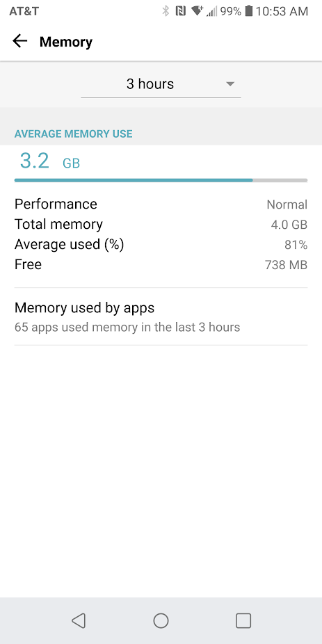

Freeing up memory to improve performance is a common misconception with Android and other 'nix variants. With most people being familiar with Windows and the Microsoft paradigm, it is hard to break this habit. In this case the reverse is true. The phone performs much more efficiently with less free memory. You are seeing all those recently used apps because Android is pre-caching them for you so when you go to actually use them, they are available much more quickly.
This is what I see and my phone runs perfectly fine.
I still think one of your apps is bogging down your performance, but without having your phone to examine, I can only guess. Things like cache and temp files filling up or exceeding a reasonable size would be my first place to look.
