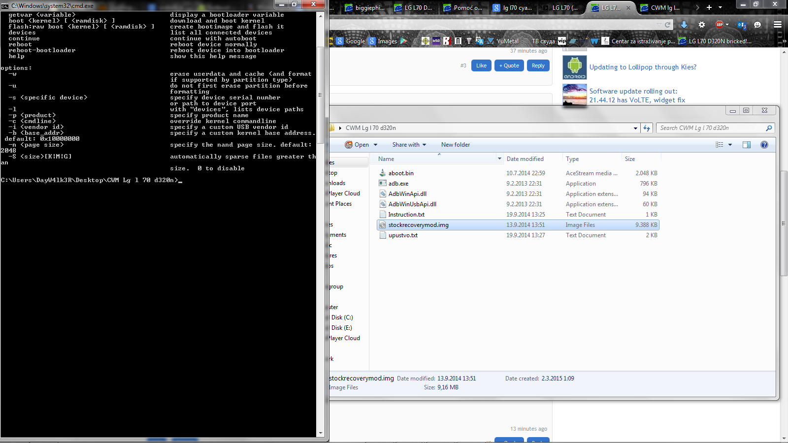

Did it, and it won't boot into cwm:
And when I do fastboot boot recovery, it says no such file or directory:
'fastboot boot recovery' someone did a mistake
either you're trying to do
fastboot boot recovery.img
or fastboot reboot recovery.
hahaha, omfg I did, it was that "little" mistake that caused problem the whole time, I booted cwm now...
Thank you all very much, I'll post the results later! Cheers! :)
