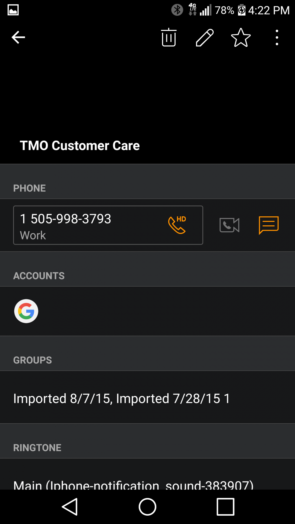

I have a very baffling issue on my new LG V20 on the T-Mobile network.
When I try to make a call from my contacts, I open the contact and the tap the phone number of that contact. (I have attached an image of a sample contact named "TMO Contact").
Normally the call would be placed without any problems. Normally is the operative word here.

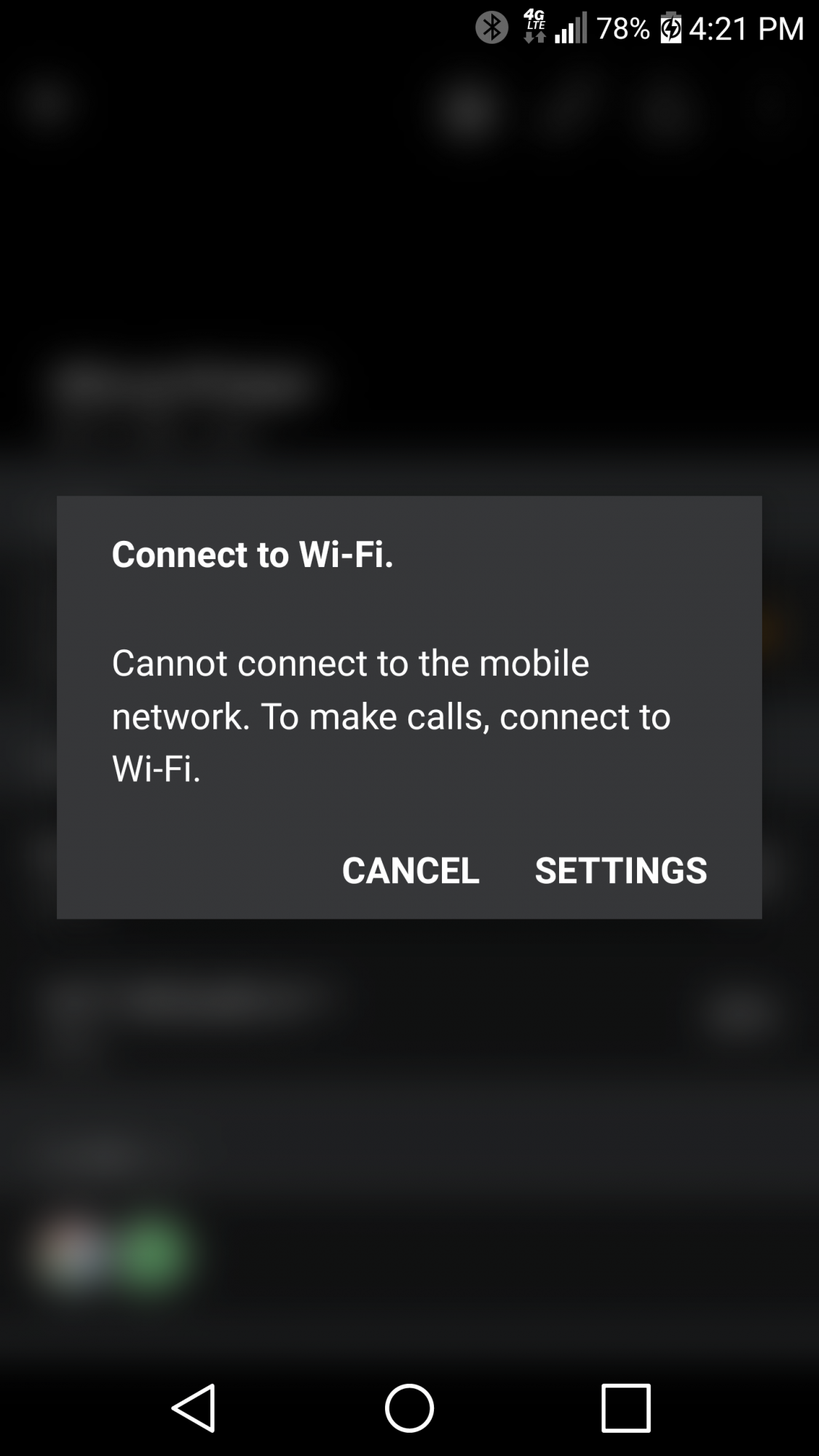

There are numerous times daily that when I try to make a call in this manner I get an error message instead. The error message tells me to use wifi as the phone cannot connect to the mobile network. (I have attached the error message image as well).
To complicate matters further, when I get the error message I can tap on the "cancel" option on the error screen and then tap the little camera icon to the right of the contact's phone number. The call usually goes through at that point.

I have that issue too but only from thw short cuts I made. Same phone. If i dinr use my shortcuts it dials fine
I was beginning to notice the same thing. When I get the error dialing from a shortcut, and then if I go directly to the contact the call will go right through. My guess is that this is an LG software error. I wonder if the phone shuts the network connections off when not in use.... and the shortcuts don't wake the connections up the same way as the contacts entries do...

The work-around for this issue is instead of selecting "copy contact" to your home screen, select "direct dial". That fixed the problem.
I am convinced that this is a software issue that LG either doesn't know about or refuses to fix.
