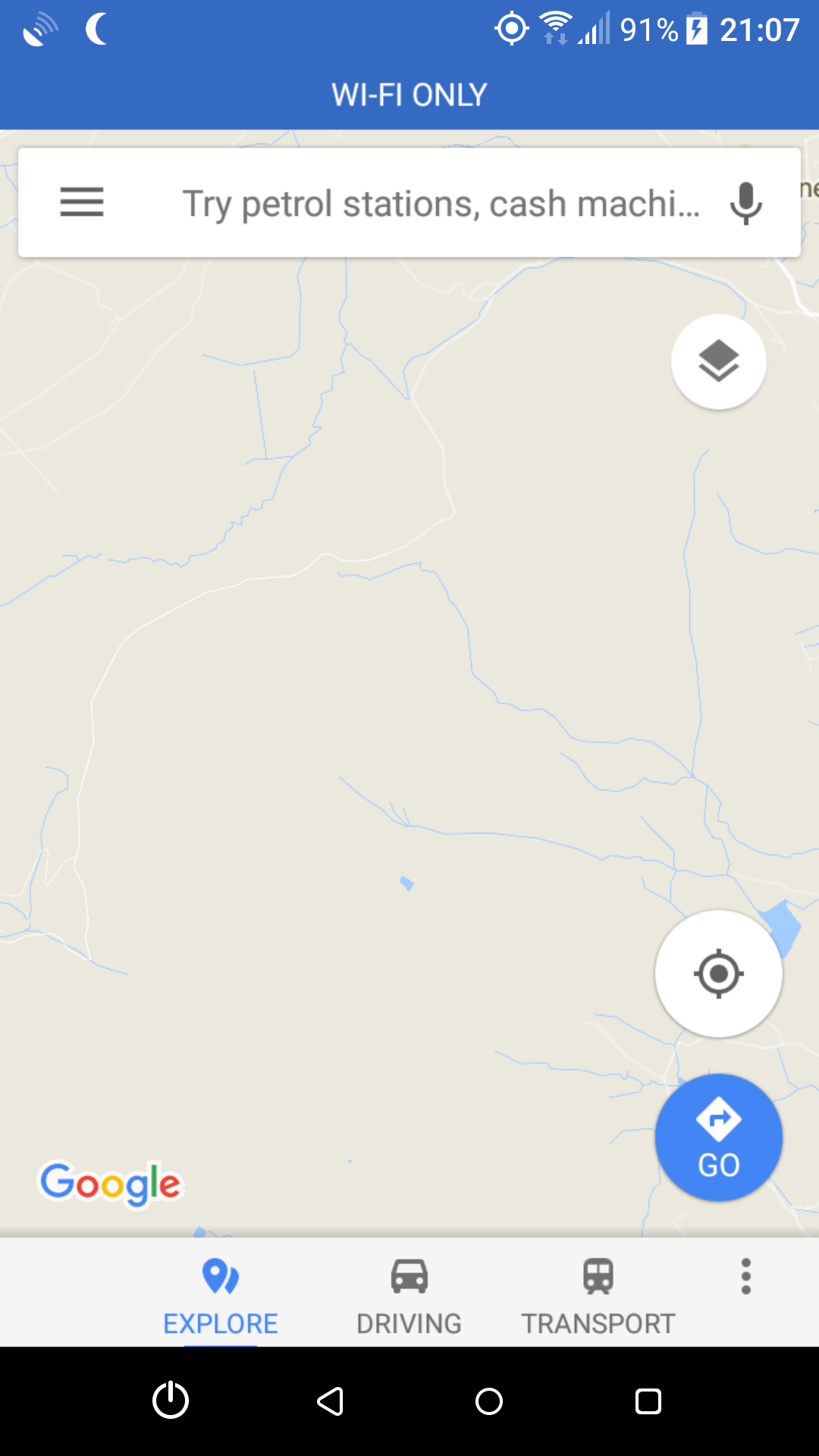

Something else to try is select 'Battery saving' mode in Location settings which then uses WiFi and mobile network geolocation. Make sure your WiFi is switched on and you are connected to your hub/router/WiFi access point and then see what your location status is.
Try the 'Battery saving' mode and see if there is any change in your location status.
Having done that and noted the result, turn your WiFi off and reboot your device ie power down then power up. Keep WiFi switched off and your device should then use mobile network geolocation which will locate you using whichever mobile network masts you are within range of. Accuracy depends on the number of masts and the distance you are from them. In my case it puts me just under 700 metres west of my true location and is accurate enough for location based services such as weather info.
If you then switch on your WiFi and reconnect to your hub/router/access point, WiFi geolocation should now show you close to your hub/router/access point location.
I have two WiFi access points some 20 metres apart and my location within the property as shown on Google Maps (and other navigation apps) depends on which access point I'm connected to and is a stable location clearly within the same room as the access point.
GPS accuracy depends on the number of satellites that your device is receiving signals from and also the strength and consistency of those signals and will give an error margin accordingly. In my case WiFi geolocation is more accurate and stable than GPS location when I'm in the property.
What is also relevant is whether or not your WiFi access point is in Google's geolocation database. When I moved home two years ago my WiFi geolocation put me at my previous address some 60 miles away until the database was updated, which was 4 to 5 weeks later.

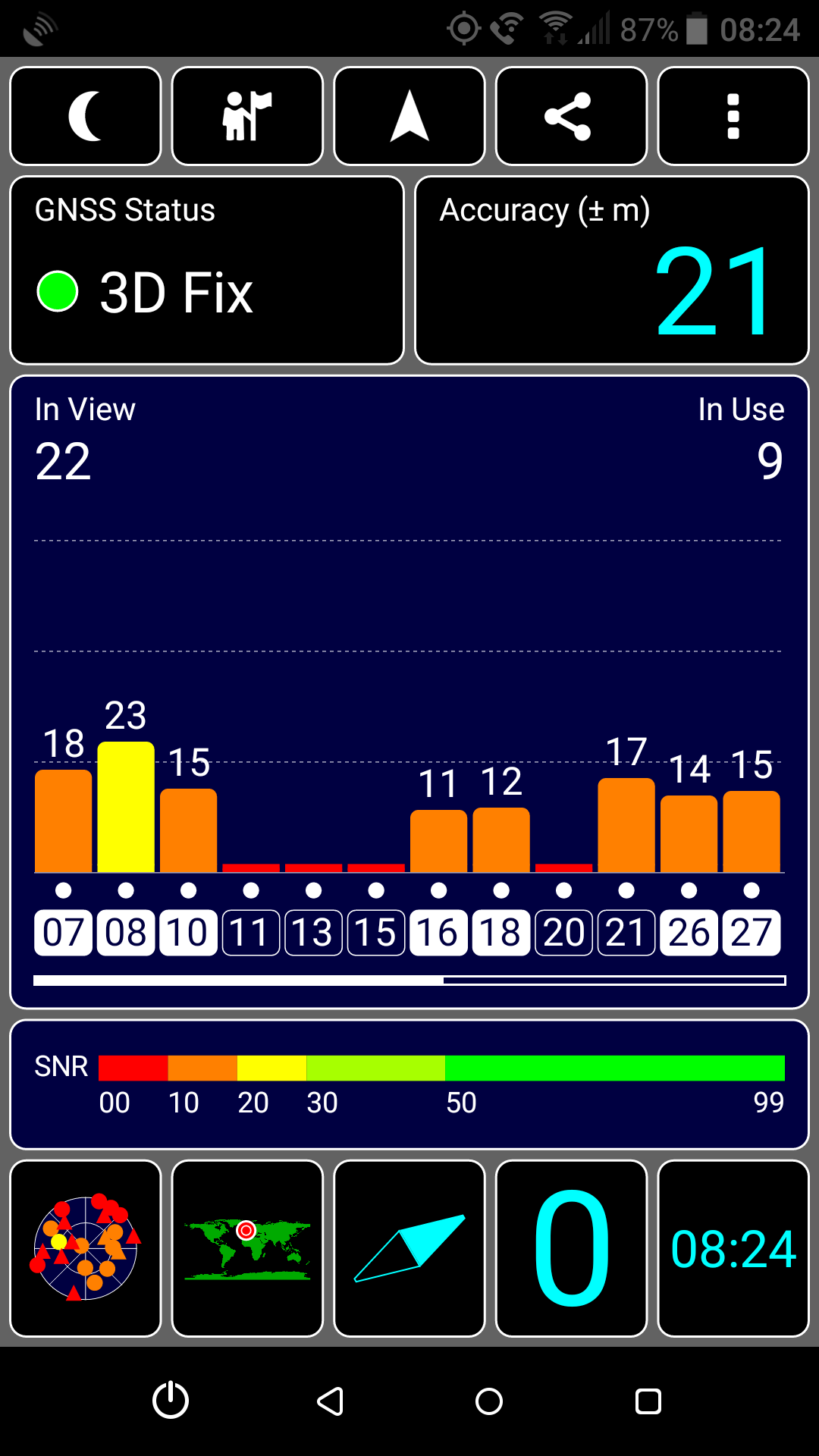

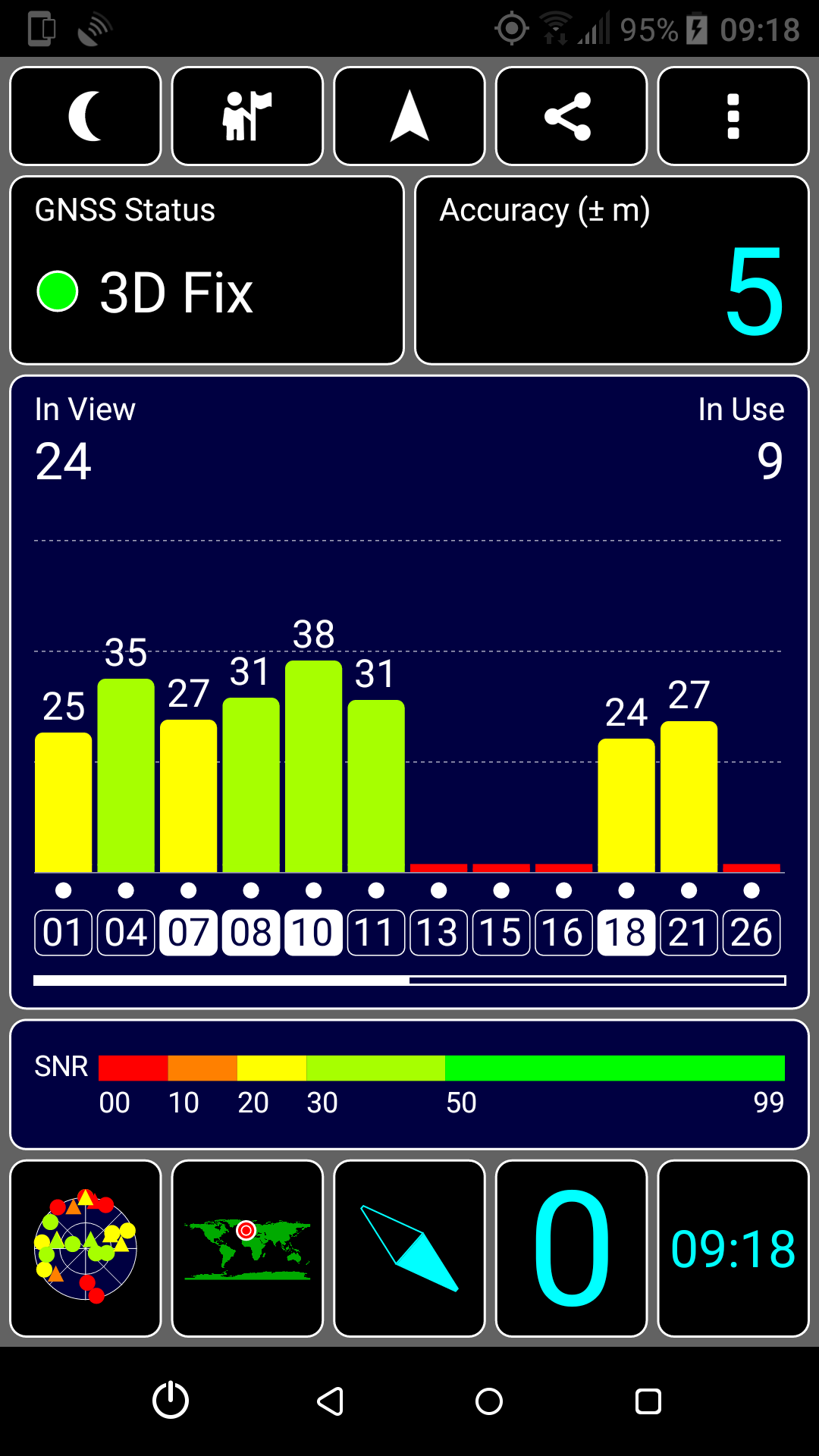

Just to add a bit more info to my last post, the following screenshots were taken this morning. I was using the 'GPS Test' app.
The first one was taken in the middle of an upstairs room and the second was taken outside the building showing the difference in the number of satellites in view and their respective signal strengths both of which affect the stability and accuracy of the GPS location.
In the indoors situation it tends to go in and out of 'fix' as the strength of the signals varies, this could be giving you the 5 to 30 feet variations.
One of my WiFi access points is in the room and geolocation gives a steady and accurate location so generally speaking I only ever use GPS for navigation purposes.
