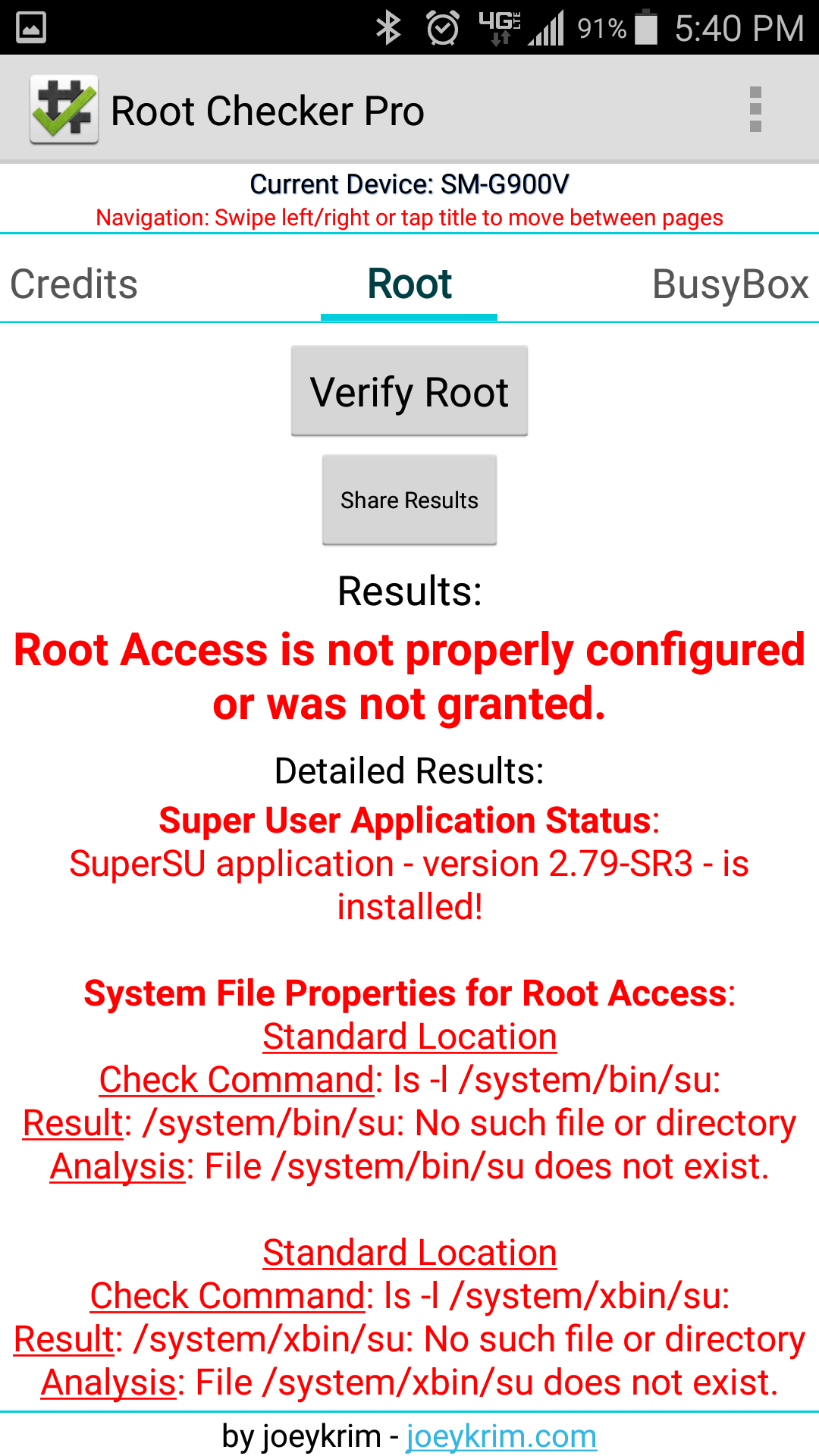

I'm not worried about any apps, or losing data, or anything like that.
I just want to get my phone back to root access.
I deleted some system files that I guess I shouldn't of. That's why my keyboard stopped working.
I use my phone for my buisness, so I needed it working, so through TWRP I just did a reboot.
But using the root checker pro app, it said 'root access not properly configured'.
So I know I am missing a step somewhere.
Everything on my phone was backed up, but I don't know if the accual system itself was backed up at anytime.
