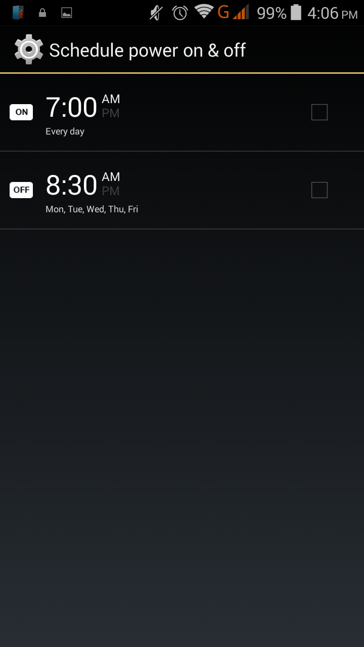

All my previous and current phones and tablets have that feature that made me assume that its available for all devices. Try checking your settings again.
