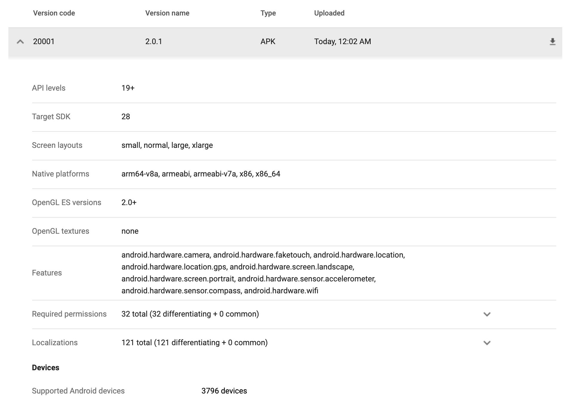

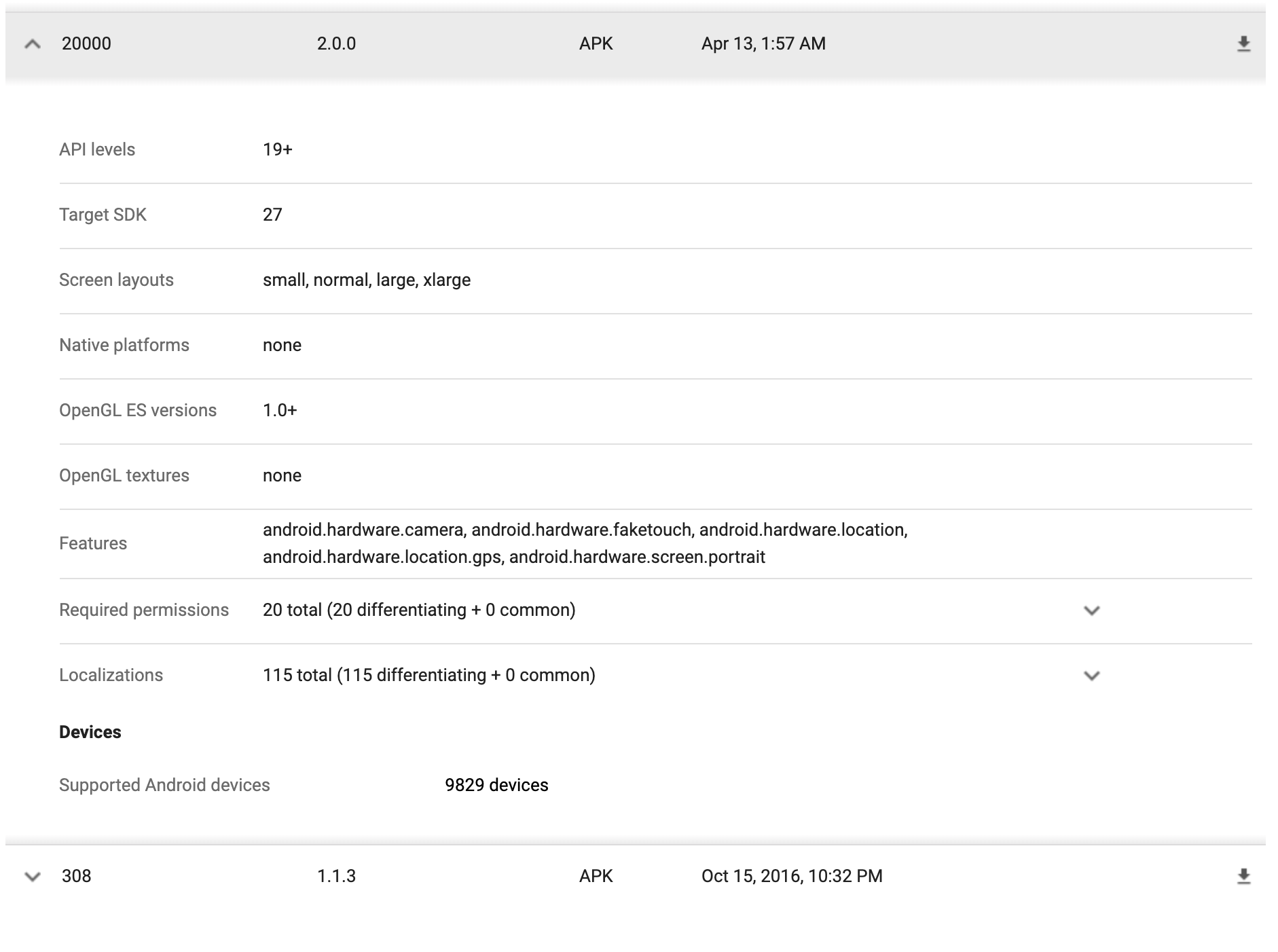

I could really use some advice, our current production app shows 9829 supported Android devices. I uploaded a new binary for testing and the number of supported devices dropped down to 3796. We have added new features that have created new requirements and so I expected to lose some device support but this number seems rather broad. We are pushing into newer device requirements for AR and Geo based experiences so our primary target is more recent hardware, but of course we want to support as many devices as can be supported. Should I take this back to the drawing board or do these number sound reasonable? Enclosing a summary of each build. I am also curious, if a device is listed as unsupported does it not show up as an app a user can install in the Play Store based on their device or does it show as available but unsupported?

Could it be that your new app version is now supporting hardware not available in all android devices? If the answer is yes, then this should explain the drop. I can't give you a precise answer, but you'll need to assess the differences between your new and older release to find your answer.

Thanks for the response and great suggestion. Turns out it was new hardware requirements as you suggested. The compass was the big limiting requirement. Some of the new features require the compass sensor, but I'll update the app to only support those features on devices that are so equipped and make it as not required, e.g.,
<uses-feature android:name="android.hardware.sensor.compass" android:required="false" /> in Android manifest.
Interestingly when requiring the android.hardware.sensor.compass only 3796 devices were listed as supported and after making the requirement false 10801 devices were supported, which means that 7005 devices were listed as not supporting the compass sensor, 65% at the time of this writing. Found that a little shocking.
