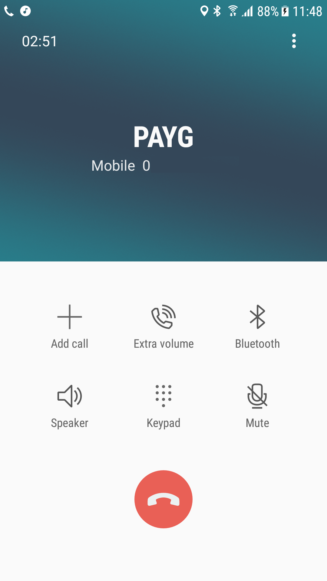

Thanks for your reply. I hadnt added your lines, but when I did, it made no difference. The intent-filter in my manifest now looks like this:
<intent-filter>
<action android:name="android.intent.action.MAIN" />
<category android:name="android.intent.category.LAUNCHER" />
<action android:name="android.intent.action.DIAL" />
<category android:name="android.intent.category.DEFAULT" />
</intent-filter>
but this still looks like it works in the same way. When my app makes the call, I get the attached screenshot come up. The call is made, and I can return to my app with the call live. What i would like to do is suppress this screen.
I have had a look through the link that you included, and I am a bit worried that in the article it says:
"You can replace only the Dialer that way. The actual calling thing (what you see during calls) can't be changed."
Does this mean the what I am seeing?
Thanks again for your your help
Mike
