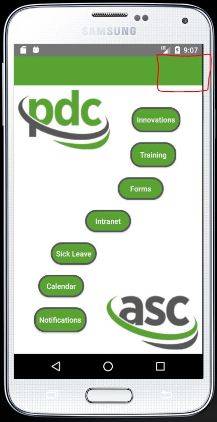

In my fragment I have the following, however my menu never gets inflated. I have a Toolbar in my layout of the fragment.
In my Logcat I get the following output (filtering on TAG which is "Fragment1"). There is no "Woohoo" output, showing that onCreateOptionsMenu never gets called.
Could someone assist me please? I use a ViewPager on my MainActivity to hold all the fragments in.

At this point, apart from setting up the different fragments, and putting buttons on each fragment to move to a different fragment, I have done no "real" programming in it, i.e. there is no functionality built yet, it just swops between fragments, so I wouldn't even know what might be stopping it being called.
The thing is that it never actually gets called (the onCreateOptionsMenu) since it never logs any response in the Logcat, whether during the onCreateView, or after it has finished.
However, in going to another fragment and then returning to this specific fragment where I am trying to set up a menu, it does keep logging the "1", "2", & "3" from the onCreateView each time, just never the "Woohoo" from the onCreateOptionsMenu. My output shows the Toolbar (set up in the fragment xml file, it just doesn't want to show the hamburger item I am trying to place on it created in the top_menu.xml file.
I am using Windows 10 as my OS, API 23 (Marshmalow), Android 6.0 as targets.

I am uploading an image of what my fragment looks like, in the drawn in red square is the item that isn't being shown, it is a "hamburger" i.e. 3 horizontal lines icon.
Thanks again for trying to assist.

I may be wrong on this, but I think it may be that you're not invoking anything to bring the menu into the activity. From what I can see, you need to have some sort of toolbar/actionbar that you initialize in your activity - see this example https://www.javatpoint.com/android-option-menu-example
So you will need an action bar XML and you'll need to invoke that in your onCreate
From what I've seen/read, this is when you would want to inflate it into your Main Activity. However, I am using the ViewPager container in the main activity to swop out my fragments, and hence (I think) I need to inflate them not into the activity, but into the fragments. For this reason setHasOptionsMenu(true) is called in onCreateView in the fragment, and not onCreate in the main activity. AlsoonCreateOptionsMenu has a return of void as opposed to Boolean if inflating into the main activity.
The idea being that the fragments get set up and then the main activity has minimal code only to hold the ViewPager which handles the fragments.
The xml for the menu bar is done in top_menu.xml as below:

The toolbar is set up in fragment_main_layout.xml as
Code:
<android.support.v7.widget.Toolbar

and in FramentMain.java, the call to inflate this menu (in onCreateOptionsMenu which doesn't get called) is:
Code:
menuInflater.inflate(R.menu.top_menu, menu);

Thank you for the suggestion, and I will certainly look into this Navigation Drawer as a follow up project. I have seen it spoken about in trying to get this issue of mine sorted.
It isn't the overflow icon that I am trying to put on the menu however, it is the hamburger icon (3 horizontal line) - I want to use this to go into further settings for the fragment.
This is the drawable\ic_menu.xml for the icon

The tutorial I followed to get the fragments set up in the ViewPager was from
with CodingWithMitch.
I asked a few questions underneath, but unfortunately Mitch only answered to a certain point.
All my fragments switch in and out perfectly, and I am quite happy with how ViewPager does this job for me, I just need an icon to appear on the Toolbar in the main fragment which I can't get right.
At this point I am considering transferring all my fragment code to the main activity code to test if I can get the menu icon to inflate on the main activity (discarding all separate fragments). But it just seems that I am missing something fundamental to get this working, if only I could get the fragment to run the method
onCreateOptionsMenu
Hi! Have you resolved this yet? I am struggling terribly with this very problem. After a ton of searching I found one suggestion that actually did allow my overrides to get called as expected. The suggestion was to change the Activity class declaration. There's an incompatibility there. So if you have this: extends Activity, try changing it to this extends AppCompatActivity or vice versa.
This change does allow my overrides to get called. Unfortunately I still do not see my menu!!!! FWIW, I am working with an Activity not a Fragment. Please let me know what this does for you. TIA
