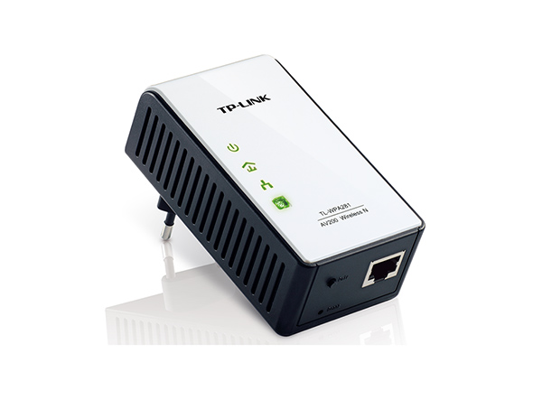

Check this out...
http://www.tp-link.com/en/products/details/cat-18_TL-WPA281.html
Yes I know Ethernet would be the ideal solution, I was just wanting to know what the issue is with WIFI on these boxes.
I have to install for my clients and powerline extenders can get very messy, added expense...and don't work when the house is on 2 different circuits.
