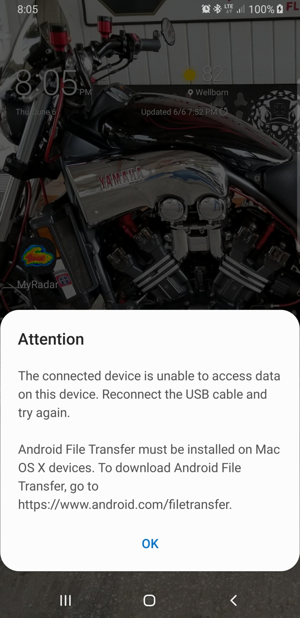

I tried plugging my phone into my chevy radio and other radios via a USB cable and tried to access the media files that way and I get this message on my phone.
And no reconnecting does not solve it.
Everything worked fine before the updates. Now nothing works right over bluetooth or cable connection.
What has Android or samsung done that is blocking access to the media files?

Is your phone unlocked when you connect it to the car system. Because if it's screen-locked nothing can access content stored in it, as it's for security.
I've always set the advance settings in the bluetooth settings to auto connect and auto play in my Chevy and it has always started to play my music files once the bluetooth connection is connected. And it has never given any problems till the past month.
As far as the phone being locked, it was not locked and it still did not work.
