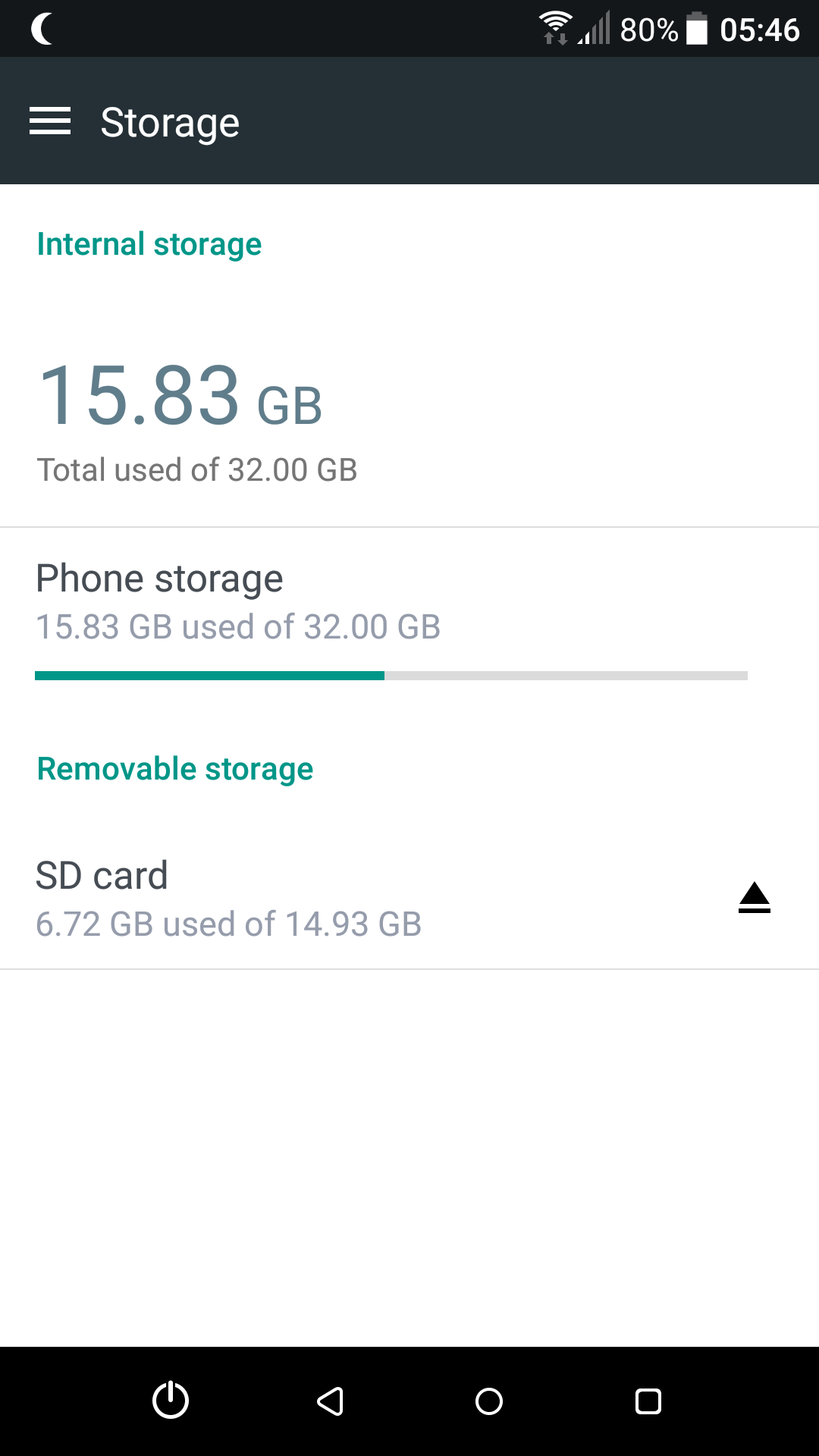

Hi, I don't know whether the S7 Edge is the same as my HTC M9 in this respect, there seems to be ever more differences between devices these days, but on my M9, when a new SD card is inserted I have two options, to format it as 'portable' SD storage or Internal 'adoptive' storage.
The former means it is separate from the internal storage and can be removed and used in another device or read by laptop/PC.
The latter means it becomes part of the internal storage, it is encrypted during this process and cannot be removed and used in any other device without reformatting.
I have mine formatted as 'portable', ie removable, storage and the two storage areas are quite separate. I can copy files from one storage area to the other, and delete them as appropriate.
