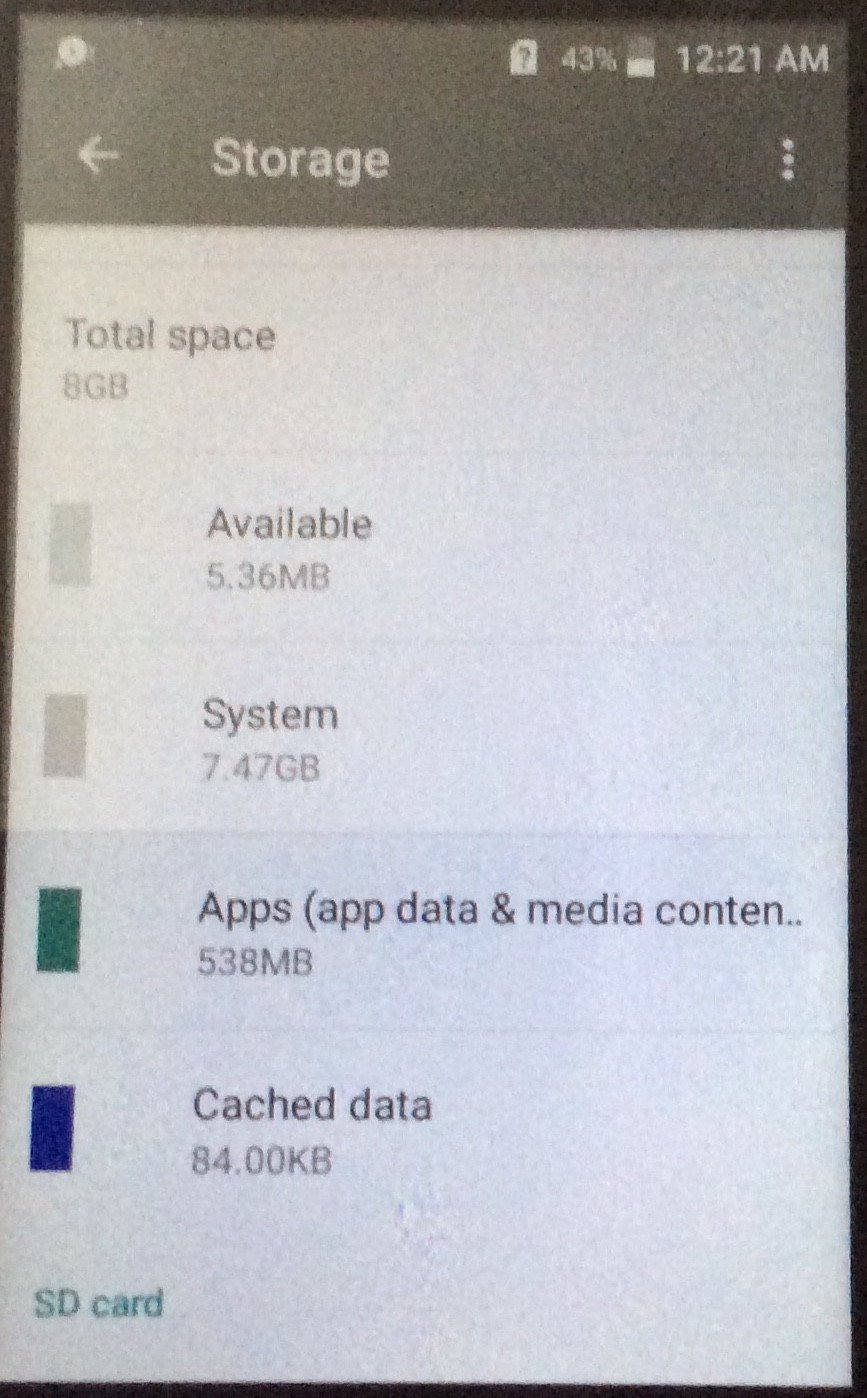

Now I Have specific numbers:
Total Space: 8 GB
System: 7.47 GB
App: 689 MB
Available space: 8.79 MB
Now I uninstall 23 preloaded apps (Around 400 MB):
Total Space: 8 GB
System: 7.47 GB
App: 538 MB
Available space: 5.56 MB
These numbers don’t make sense.

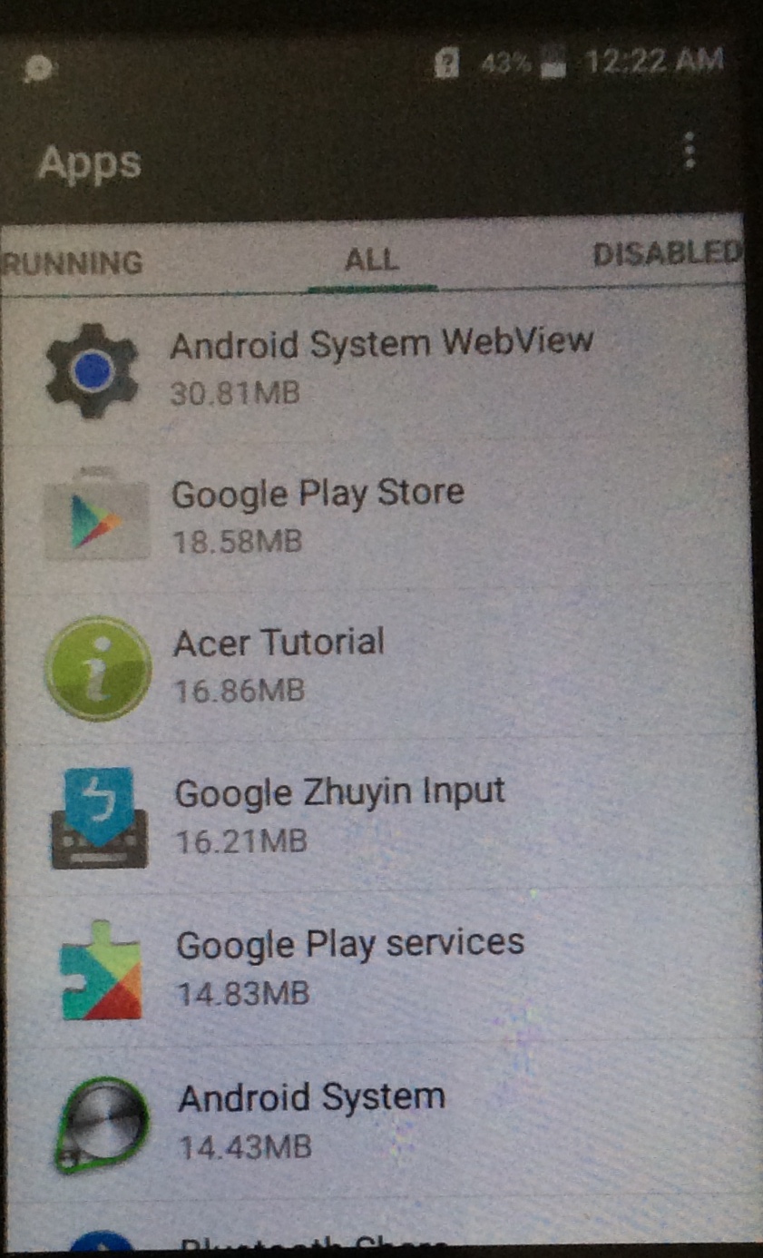

I see all the apps that I have installed (which are all system apps) and they all total around 100-150 MB not 583 MB
Android 5.1.1 shouldn’t take that much space either.

If the bootloader is unlocked you can erase partitions using a computer. Install a program called fastboot on it, boot the phone into fastboot (or download) mode, which you can select from the bootloader, connect to the computer via usb and then use the command "fastboot erase partition-name". But erasing the data and cache partitions is just what a factory reset does, while erasing system will just mean that your phone will no longer boot into Android (i.e. don't do that unless you have a way of reflashing it).
I with I had more faith in the system storage menu's information, but in their efforts to be "simple and user friendly" the information they present is often less than clear. Unfortunately the best way I know to get the actual partition sizes involves installing an app, which I doubt you can do at the moment.
If you have the bootloader unlocked have you made any other modifications? If by any chance you are rooted and have a terminal emulator + busybox we could use linux commands to check (just typing "df" at the command line should suffice to get the actual partition sizes). But if you've made any mods that might also be relevant to the problem.

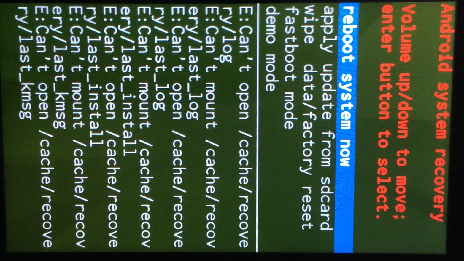

Possibly the bootloader is corrupted if the partitions are being misunderstood - in which case you are lucky you can do anything at all.
Yeah, a firmware flash might be worth a try. That should replace everything (bootloader, recovery, ROM, radio, the lot). And hope that it's not that some part of the storage has failed.
Those error messages don't look too severe in themselves (not being able to open recovery log files in the cache partition). The question is whether they are a side-effect of something nastier.
