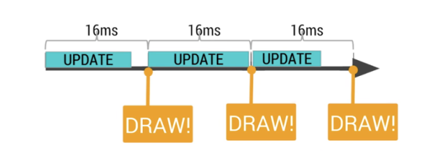

What Causes Slow Rendering?
System tries to attempt redrawn your activities after every 16ms. This means that our app has to do all the logic to update the screen in that 16 ms.

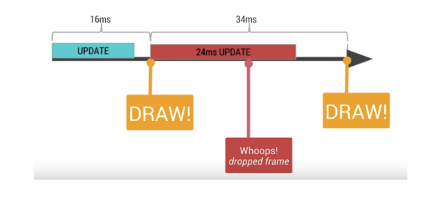

what if our app can’t complete the logic in 16 ms?
0*xyCHR4_24fID9cn_.
It’s called dropped frame. For example, if your calculation takes 24 ms, this case happens. System tried to draw a new picture to the screen, but it wasn’t ready. So it did not refresh anything. And this caused, user’s seeing the refreshed picture after 32 ms instead of 16ms. If even there is one dropped frame, the animation will start not to be seen smooth.

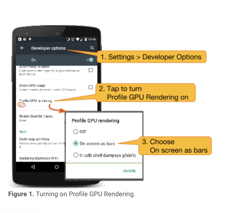

2. Profile GPU Rendering
Profile GPU Rendering gives a quick visual representation of how much time it takes to render the frames of a UI window relative to the 16-ms-per-frame benchmark.
Enable Profile GPU Rendering
0*t5DPyvwfqx6cW_yW.
On your mobile device, go to Settings > Developer Options.
  • In the Monitoring section, select Profile GPU Rendering.
  • In the Profile GPU Rendering popup, choose On screen as bars
  • Go to the app that you want to profile.
0*xyCHR4_24fID9cn_.
0*t5DPyvwfqx6cW_yW.
