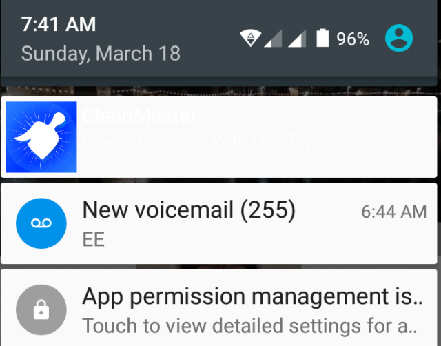

My OTHER phone came up with this werid notifications
That I can't get rid of
The app it comes from

You're using Clean Master? It could be that's what's doing the ads and browser tab pop-ups, and making it behave funky?
Cheetah Mobile Clean Master is notorious adware/spyware, strongly suggest you uninstall it.
Here's a problem: it's not even installed!
So it's really a notification ad for Clean Master?
However..."CR MTKcamera" What phone have you actually got there and is it rooted? Because apparently CR MTKcamera is installed by KingRoot or KingoRoot, along with a load of other crap(malware). You may have to re-flash the original firmware in your phone.
