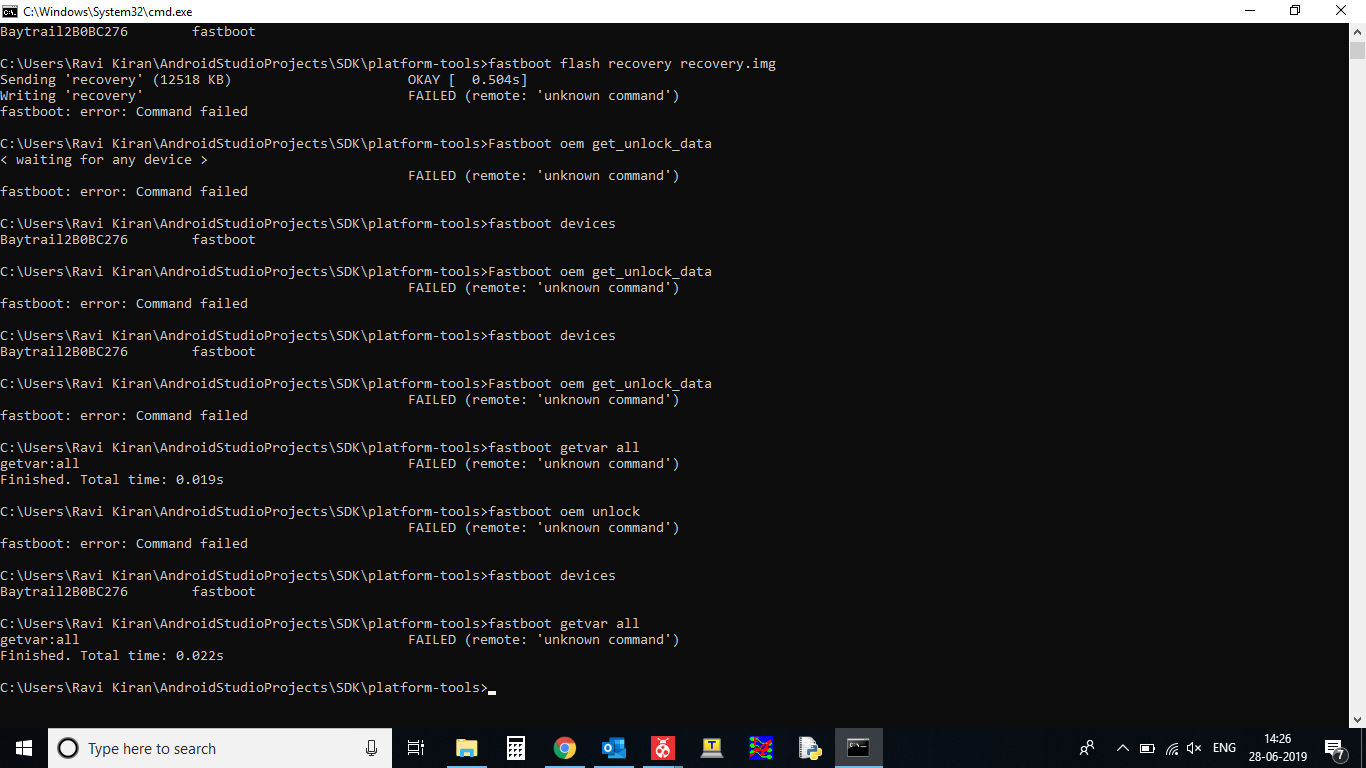

Iam trying all fastboot commands but for all commands it is giving error:FAILED (remote: 'unknown command')

Could be the boot loader is locked? That would certainly cause "unknown command". Are you trying to root this tablet or something?

But I tried to unlock bootloader by using command "fastboot oem unlock"
Iam getting same error while "fastboot oem unlock"
Yeh, OEM unlocking maybe impossible for this particular device?

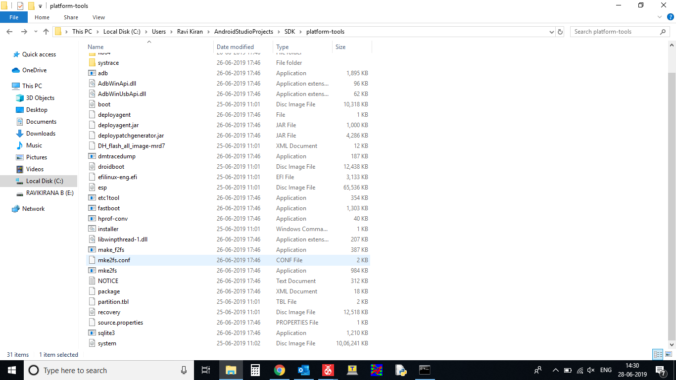

There's various disc image files and recovery files etc, are you sure they're actually built for this particular tablet?

However, I did notice that you were trying to flash the recovery. I assume that this meant that you were trying to flash a custom recovery, because there's no point in flashing a working tablet with the stock recovery. If so, that suggests that someone has built a custom recovery for the tablet, which means there is a way of unlocking it, in which case you could ask the person you got it from how to unlock the tablet.
Note: a custom recovery must be built for the specific model of tablet. If you were trying to flash a recovery that had been built for any other device, even a different tablet from the same manufacturer, then you are very lucky that it didn't work as you would almost certainlyhave bricked your device if you had flashed it.
