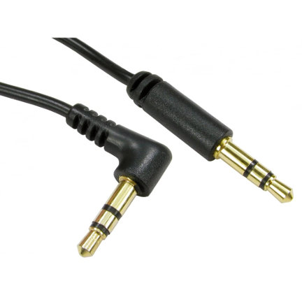

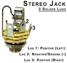

Well the whole problem appears to be when you plug a set of wired headphones in you can hear sounds in the left channel but the right channel is silent. Again, try to visualize what happens when you plug your headphones into your phone.
Plug end (a typical plug end of the set of headphones/earbuds, and keep in mind the sequence -- ground, right channel, left channel is an industry standard and does not vary):
Note position of metal connector for the right channel audio signal.
Socket (essentially the component as the bottom of the headphone jack opening on your phone):
So when you plug in your headphones, you're creating a circuit where that the left channel metal contact in the plug has to be in direct contact with the left channel metal contact in the socket, and the same applies to the right channel metal contacts, and grounds. In your instance something is apparently messed up with the right channel contact of the socket, since the same situation is apparently occurring with any headphone you plug in. Again, it could be something you'll eventually be able to clean but that vague reference to water damage could also be a bigger problem -- i.e. rust on that right channel metal contact.
So try to clean up that headphone jack but be very, very careful. Or think about using Bluetooth more.
