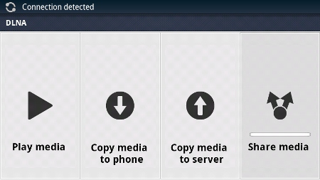

Finally on your phone you should see something like this when you have the DLNA app open.
When you hit the play button you will see the Shared Content or Shared folder. Just drill on down until you get the idea and you will get to see/hear your media on your phone. To listen/view to the media that is on your phone on your computer or other device touch the Share Media button on the phone and the bar below will turn green. On your computer in the privilege tab of settings you must have "Allow" checked on the bottom of the screen.

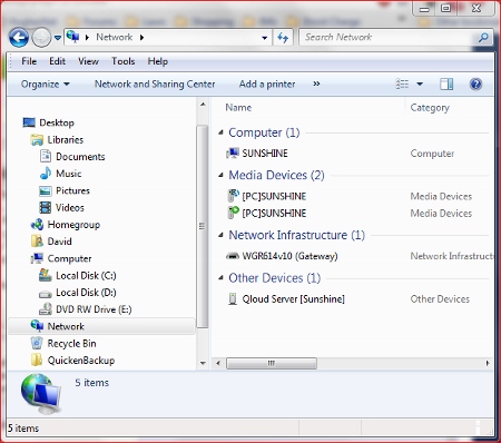

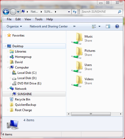

In internet explorer you should see a network icon like on this pic of mine. Double Chick on your computer, on right and it should expand to show your shared folders. If none are there you need to go to the folder and right click it and go Sharing and choose Advanced Sharing and go thru the screens to Share the Folder.
