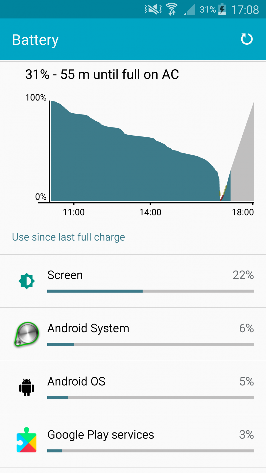

This could be simply a case of my battery needs replacing. I noticed some odd behaviour the last few days such as I thought i had charge left then suddenly the battery is dead. So since its my day off I decided to intentially run the battery down to see for myself. So I've just been general browsing, a few texts, a little social media just letting it steadily decline. Then I watched it go from 26%, to 22%, to 10% to dead. In under a minute. Its an official samsung battery and other than that the phone is amazing with normally the best battery life of any phone i've had. IF its time for a new battery i'm happy to grab one on line now.

Hi, sounds very much like the battery has had it, these batteries don't slowly decay like others, they will just die on you, at least unlike the newer phones we can replace the battery, one of the reasons I wouldn't buy a phone without this feature. Phil
Lithium-Ion batteries maintain pretty much full discharge rates right up until they have reached the "Maximum Number" of Charge/Discharge cycles....
and then, they just poop out...
One more thing to be aware of, Lithium-Ion batteries like to be kept in the upper 2/3rds of their charge status.... so, Caveat Emptor if you insist on always running them down flat between charges. That is a guaranteed way to kill them prematurely.
The manufacturers recommend that we use 40% as the bottom of the discharge cycle, and top it off from there. I have "tried to" observe that recommendation, and I have yet to ever replace a Lithium-Ion battery in any of my smartphones. If, you observe this method, it greatly extends that "Maximum Number" of recharge cycles.

You got that right. I'll never ever change to a phone without the ability to simply replace the battery. I'll order a new one now be back to a full strength phone. Appreciate the confirmation.

I never make a habit of running down, today was just to see what was going on with the sudden switch offs. I am one of those that always tops my phone up where I can. I never had this with my s3 its a new experience on the note 4 but one thats easily fixed. Interesting to note the 40% figure... i'll bear that in mind. I was gauging it at 30% the point i'd look to recharge so when the new battery comes tomorrow i'll use 40% in future.
As an aside I have a spare battery and a charger so I always have a fully charged battery to hand, I carry the spare one in a little zip lock bag in my pocket, takes up no room and I'm never caught out. Phil

New battery delivered. Won't get it took tonight but then give it a good charge. But that's a good idea Phil this battery I'll keep as a spare. After all its fine til it gets to 30% or around there.
The 'spare' battery, keep it charged to about 30-40 percent....
more than that is useless for long life storage.
