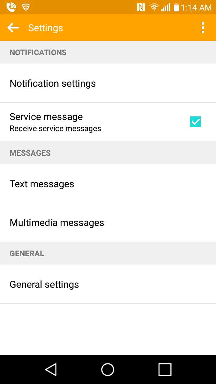

No advanced messaging setting in messaging app
24ounce
I did the Metro PCS marshmallow update
and noticed I dont have the advanced messaging under settings in the messaging app
is there a way to bring it up ?
Thanks
Heres a pic, there no advanced messaging setting
Happened to me too.
I know another person who didn't get it on the T-Mobile Marshmallow update.
I cannot figure it out.

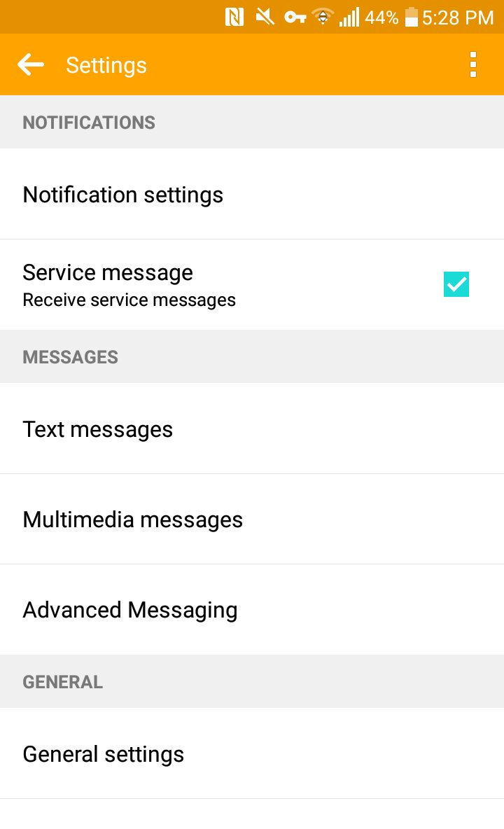

Compatibility patch showed in both my wife and my Stylos. Now I have Advanced messaging but she does not. Strange

well i wanted to flash to 20c but it wouldnt download for some reason? so i flashed 20b, took the ota and i have the advanced messaging
