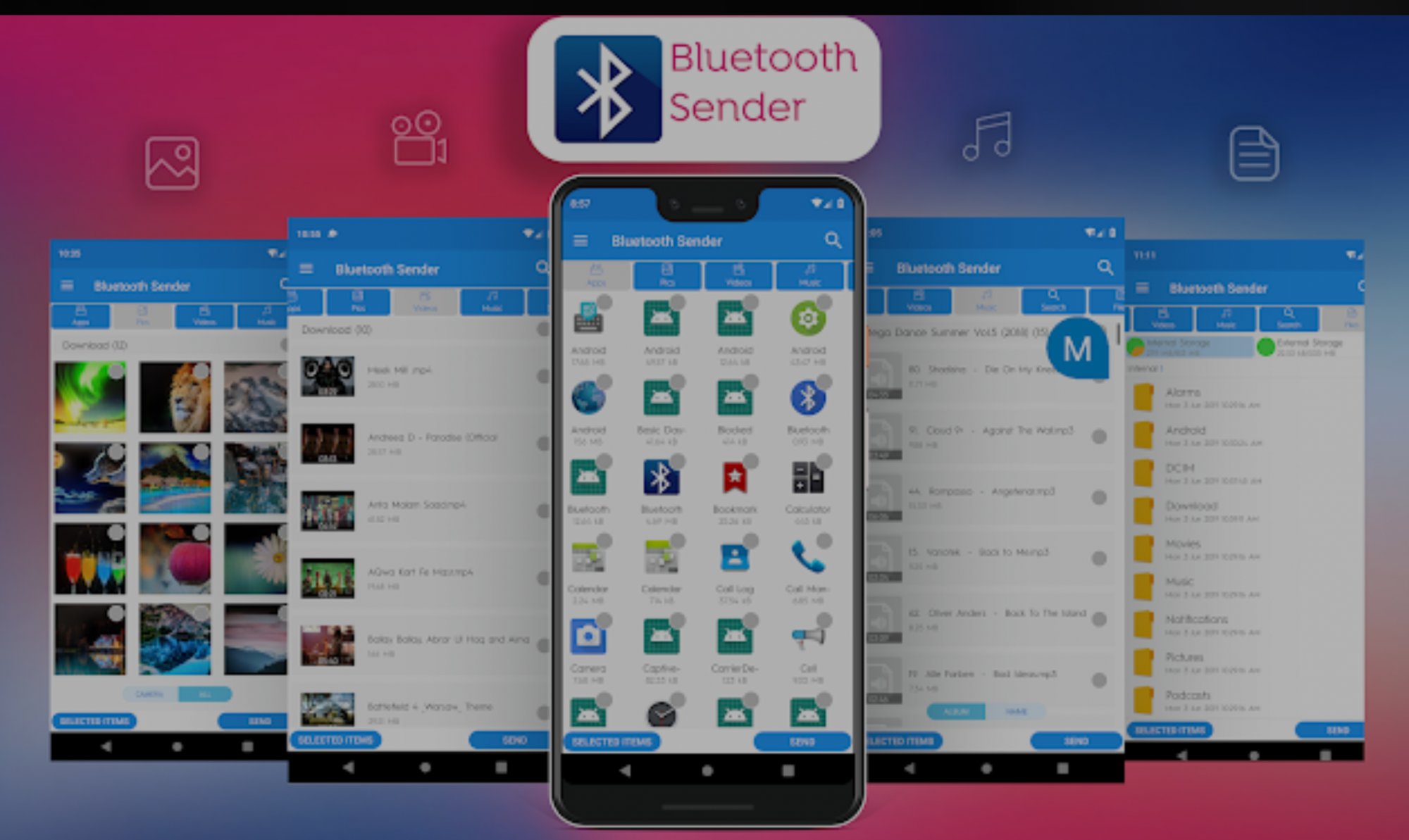

Your wifi issues might be a result of a hardware failure. However, a possible work around for transferring data from your old phone to your new phone may be possible using an application called "Bluetooth Sender Transfer and Share".
https://play.google.com/store/apps/details?id=com.shawal.sender

How exactly would I install this with no way to transfer data to or from phone?
Possible workaround. Seems bluetooth still works
installing to your new phone and sending the app to your old phone vis Bluetooth.
Well according to your on words "
Possible workaround. Seems bluetooth still works." and Bluetooth is a method of transferring data. You ask how, install the app I recommend on your new phone and use it to transfer the same app "Bluethooth Sender" to your old phone. The use bluethooth sender from your old phone to transfer data to your new phone.
Thats how you transfer data by means of bluethooth.
