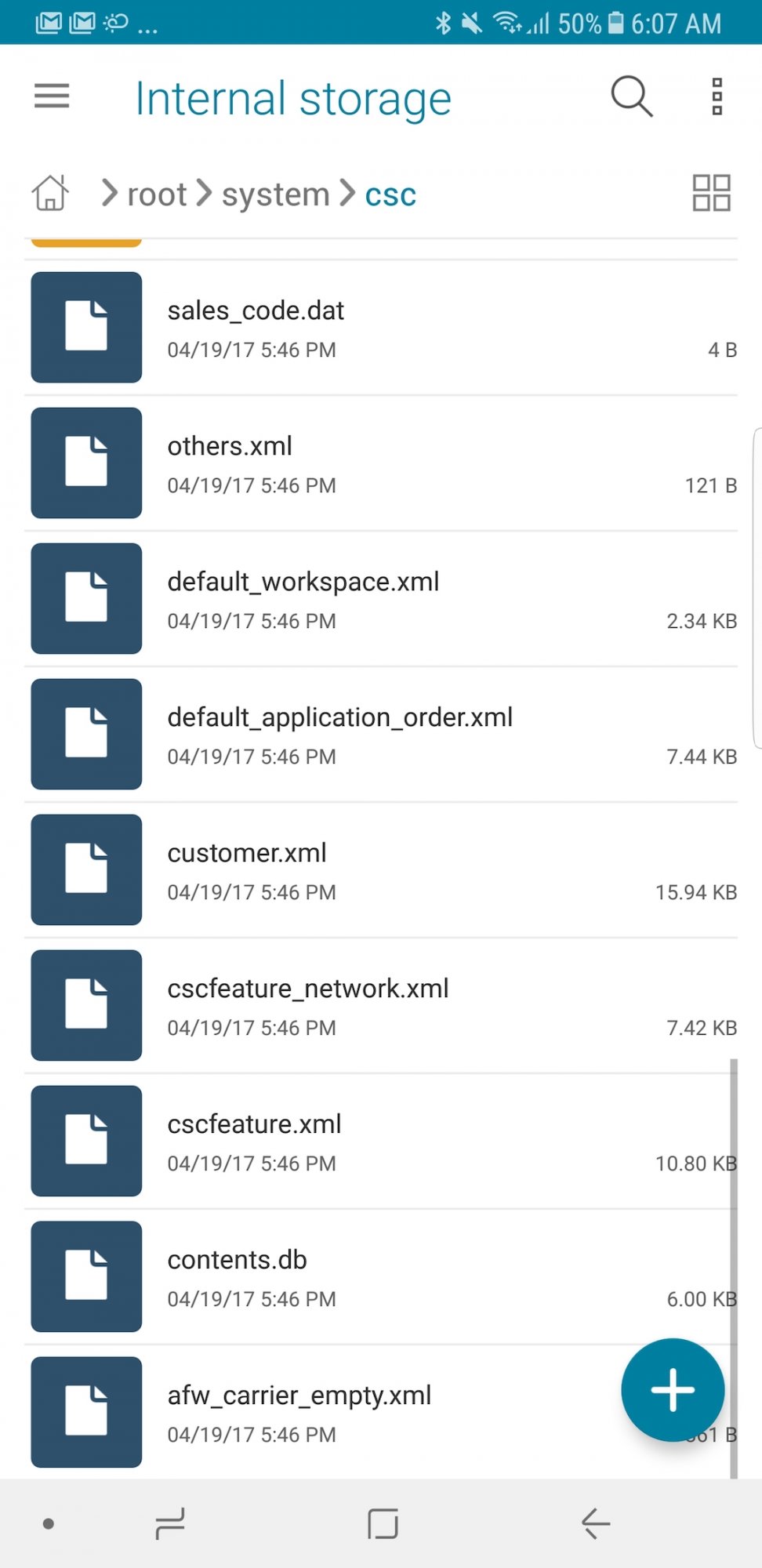

Samsung Galaxy Note8 has a builtin call recorder. But Samsung has disabled it via CSCFeature:
The cscfeature that turns it on is:
<CscFeature_VoiceCall_ConfigRecording>RecordingAll owed</CscFeature_VoiceCall_ConfigRecording>
Sad part is that to edit it, you need to root the phone. (if someone has an easier way do let me know)
When using third party apps, you will need to disable Bixby and OK Google to get the third party apps to record correctly.

My phone is rooted.
OK Google - is disabled
Bixby is workink only by Bixby key press
there is no folder system/csc/
My phone is rooted.
there is no folder system/ csc/

Go to
>rootFolder>system>csc>others.xml
You cannot view the System folder using the Samsung MyFiles (based on my experience). You will need to use a third party File explorer.
Edit that others.xml and add/edit the line to that file in same level as the other <CSCFeature...>
You will then get the Record button in the call screen.
